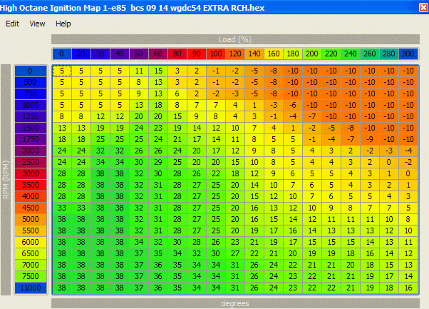

Finally got my laptop out..
I dunno if you can call it fully tuned Cause it never is
But this is for 26-28 psi E85 and Evo Green map i currently use.
