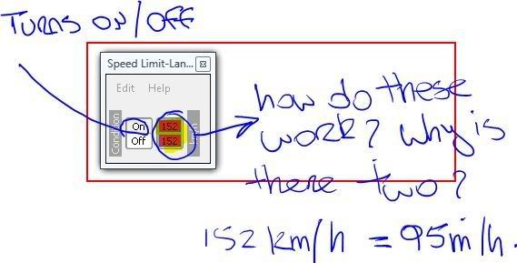

how does this exactly work? I see the possiblity of intereing two values...

Hysteresis.

What I mean by hysteresis, is like the speed limiter, IC spray coolant temp etc there is a dead zone where the value doesn't switch, this stops oscillation when you're near the trigger value. So as the revs increase it won't turn on until it reaches the higher value, and then it won't turn off going down the revs until it is below the lower value

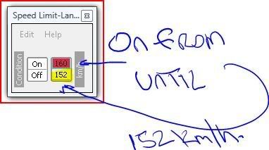

so based on the table:
ON : 110MPH <-- will kick in at 120 and cut whatevet it cuts out until..
OFF : 105MPH <--- I reach this speed again
So I guess the ON and OFF are not a push swich as I thought? Please correct me if I am wrong

You are correct. Sometimes the ECU program code has hysteresis on items like this, but in standard form doesn't use it because the values are set the same.
There is a special complication in different countries - for example in the UK the cars are JDM based with everything in km/h but have a mph converter. So for example a JDM limiter of 180km/h becomes 180mph which with our aero and drivetrain losses might be tricky to reach on the standard turbo.
Most people just set the values high enough that they don't worry them... but no doubt it might become a target for some sort of valet mode in future.
I suppose the last thing you want is instability at high speed from a bouncy speed limiter. I've not crashed into the Evo's one, but German stuff at 155mph (often higher indicated) is smooth as you'd expect.
