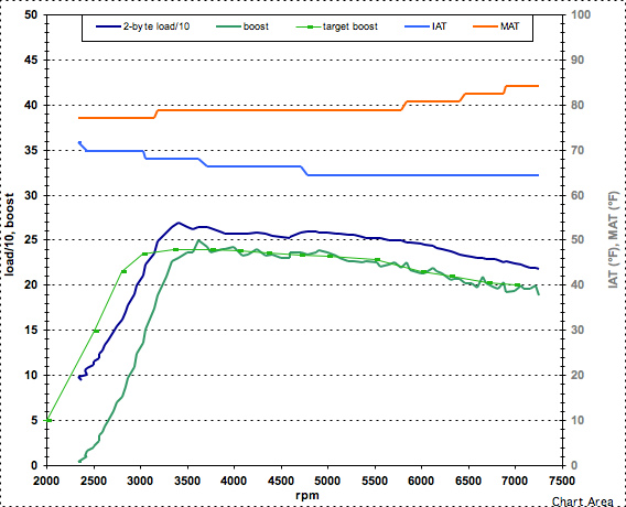

Added a pic to the first post in this thread showing my install. Here is a plot I got today of manifold air temp versus MAF air temp during a 3rd gear pull. Outside air temp was in the low 60s.
Attached Thumbnails Patch how-to: manifold air temperature logging-evoscandatalog_2008.06.05_17.45.47_3rd.jpg

the blue line is iat up by the throttle body right? the red line is air temp at the maf?
red line seems to be backwards, as you are in boost you are sucking in vast quantities of fresh air.(or are you measuring after the turbo) while you are at idle the temp goes up. At least that has been the indication I have seen logging maf ait.
Old Jun 5, 2008 | 09:12 PM
  #52
mrfred's Avatar
iTrader: (50)
Posts: 9,675
Likes: 132
Blue is temperature before the turbo. This is a factory air temp sensor in the MAF. Red is the GM sensor which is located in the UICP just before the intake manifold.

so its 20 degs difference at redline?
Old Jun 5, 2008 | 11:37 PM
  #56
RazorLab's Avatar
Posts: 14,094
Likes: 1,092
From: Mid-Hudson, NY
Looks like it goes from approx 78F to 85F
Old Jun 6, 2008 | 12:17 AM
  #57
tephra's Avatar
Joined: Feb 2007
Posts: 9,486
Likes: 67
From: Melbourne, Australia
no I mean 20degs difference between MAT and IAT.. so the turbo is heating up the air by 20degs F...
Old Jun 6, 2008 | 12:27 AM
  #58
RazorLab's Avatar
Posts: 14,094
Likes: 1,092
Ah yes. I'm sure the turbo is heating it up more than 20F, then the intercooler is cooling it off.
Yipes. Looks like after the 5750 rpm mark, the stock I/C just can't keep up with the temperature rise from the turbo spinning so fast. (And blowing all that hot air)
I found this surprsing because the amount of airflow hitting the I/C is rising as the rpm's rise too, and you would think keeping things cool.

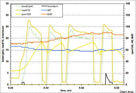

Here's 2nd thru 4th with a few seconds in 5th as well. I'm ready to test intercoolers if someone wants to send me one. :-)))
Attached Thumbnails Patch how-to: manifold air temperature logging-evoscandatalog_2008.06.06_08.36.32.gif
