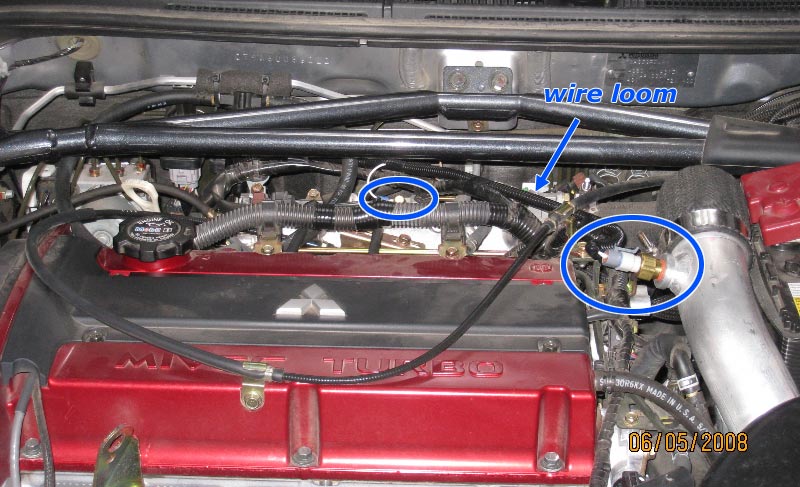

Here is a pic showing my setup. The loom with the signal wire turns down at the left end of the intake manifold, runs down the firewall, and into the tranny tunnel. The loom ends at the through-hole that people use for wiring O2 sensors. I ran the wire through that same hole and right up to the ECU.
Attached Thumbnails Patch how-to: manifold air temperature logging-img_0737_small.jpg

I think I am going to mount the GM IAT on my intake manifold in the area that is used for IAT on the uk models, it is the bung we have on our USDM models but is not tapped.
I am swapping out my intake manifold soon for a ported one so it will be the prefect time to do it.
Can you post where this is? I am assuming it is the odd looking spot next to the MAP sensor.

That is where I put mine:
