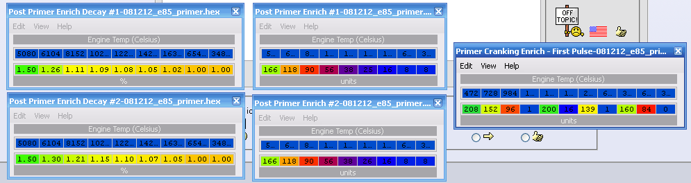

Sorry, but what would the XML be? I followed the same format you had for 94170015 (addresses were the same) and it gave weird numbers. I assume the Engine Temp addresses should be different? Please see attachment.
Thanks in advance.
I put all the stock values back for Cranking Primer (First Pulse) table yesterday night and the car had a really hard time starting up in the morning. I had cold start problems before too... until the values were changed. The table looks different than my old 96940011 ROM, but it seems like that table does help.
I get the same thing, and I believe it is correct. The units look like injector pulse width (IPW) in milliseconds (ms).
The X-axis on your tables look like that too? Why are there underscores?
Old Dec 12, 2008 | 10:45 PM
  #149
Ted B's Avatar
Posts: 6,334
Likes: 63
From: Birmingham, AL
Your engine temp scaling is out of whack. I'm using 94170015, and everything appears to be in order.
Old Dec 12, 2008 | 11:54 PM
  #150
KevOVIII's Avatar
Posts: 246
From: San Francisco, CA
Okay, I'm confused. Can someone please post the XML for 96530006?
