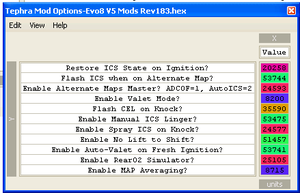

What am I doing wrong here?
When using this patch for the 96530006 Rom, these are the values I see in the
"Tephra Mod Options" table.

Did you redo your xml modifications? Are you reading the 5.10 rom?

remove the old xml from previous mods..

Thx, fixed now.
I was trying to use the new xml file with my ol ROM, I had to copy my change tables etc into the new 5.10 Rom included with the patch which the sorted it out.
