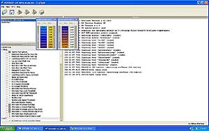

Here you go, i am also using ecuflash 1.41 and i watched the boost with boost gauge,it's like 14 psi,i raised the boost on the stock rom which got lower boost limit value and i didnt hit boost cut and with lower boost on tephra rom with higher boost limit it did cut on 5500 rpm.

ok so your "stock" rom has lower boost limit numbers than the 90550001 ROM
that means its NOT boost limit causing the problem.
in "Tephra Mod Options" - just set NLTS to 0, and then reflash and retest.
