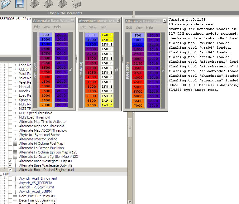

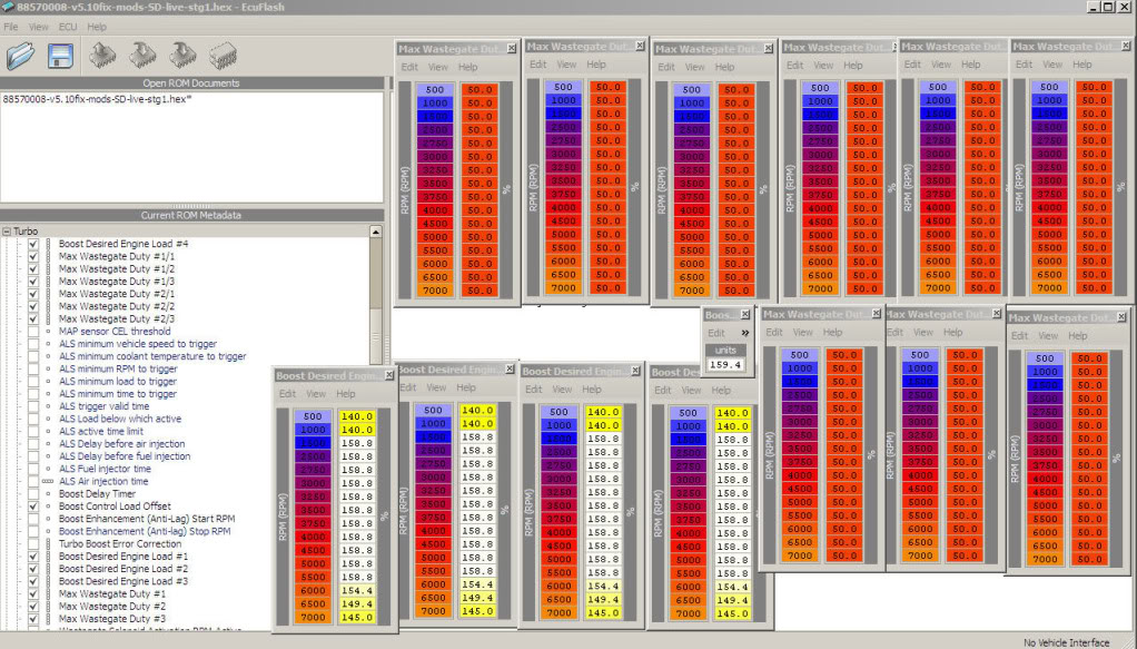

here is my issue u will need to clarify for this. i am using 88570008 on my car which is usully dual boost solenoids. does the tephra mod's WGDC use only the one?
when i put it at 20 across the board i hit 25+ psi when i should be 12 psi.
however, in my main map tables i had the WGDC extra tables (#1/2, #1/3, etc.) @ 20 as well. based on what GST told me, there are the passive solenoids and should be set at zero since i have gone from twin boost solenoids to the 3 port!
what ya think?
Old Aug 23, 2009 | 06:53 PM
  #1162
tephra's Avatar
Joined: Feb 2007
Posts: 9,486
Likes: 67
From: Melbourne, Australia
no there should be 2 alt WGDC tables.
post up a picture of the tables you have setup...
if your using a 3port then yes you only need to play with one set of WGDC tables, either #1 or #2 - depends on which connector you used..
ok just saw it, so switch the second to zero and i should be set?

Likes: 67
post up your main wgdc tables as well.
that above image should give you low boost when on altmaps (assuming your TBEC is turned off)
was 50 here but did not try boost on my main map. after seeing that my altmap spiked to 25+ i did not want to try it.

Joined: Feb 2007
Posts: 9,486
Likes: 67
what turbo and wastegate actuator you got?

Old Aug 23, 2009 | 10:35 PM
  #1170
tephra's Avatar
Joined: Feb 2007
Posts: 9,486
Likes: 67
Rolly - Have you turned off TBEC when doing your comparison?
50% on stock IX with a 3port should hit 20+ psi at peak boost.
20% should hit maybe 14?
