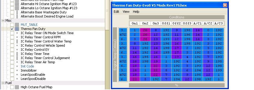

Thx, but if I use the above, I don't see any table appearing for the Themo Fan, but if I use the data from post#40, the table is there but the values seem all wrong. See pic below.
What am I doing wrong?

Make sure you add the Percent scaling to your xml. Worked for me.
What percent scaling should I be using?
As an example, should it look something like this for my 96530006 ROM
Code:
<scaling name="Percent (128)" units="%" toexpr="x/1.28" frexpr="x*1.28" format="%.0f" min="0" max="100" inc="1" storagetype="uint8" endian="big"/>
<table name="Thermo Fan Duty" category="Misc" address="45ac" type="3D" level="2" swapxy="true" scaling="Percent">
<table name="Conditions" type="Static X Axis" elements="9">
<data>On1</data>
<data>On2</data>
<data>On3</data>
<data>Off1</data>
<data>Off2</data>
<data>Off3</data>
<data>A/C1</data>
<data>A/C2</data>
<data>A/C3</data>
</table>
<table name="Engine Temp" address="6a14" type="Y Axis" elements="12" scaling="Temp"/>
</table>
I tried the above, but no tables appears at all in ECUFlash, but if I add the data form post#40, the table appears but the values seem wrong.
Change :
to:
<table name="Thermo Fan Duty" category="Misc" address="45ac" type="3D" level="2" swapxy="true" scaling="Percent (128)">
Change :
to:
Thx, working now
