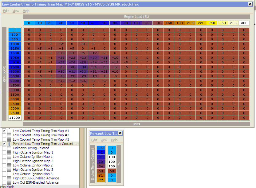

correct ign trim vs coolant temp maps
Mattjin's tables have prompted me to work through the ignition control subroutines starting from the very beginning. The sequence of steps is:
1a) Lookup values from low octane ign tables
1b) Lookup values from high octane ign tables
2) Lookup values from low temp ign trim tables ("new" tables)
3) Lookup values from low and high octance EGR advance tables
4) Use octane value to generate octane-averaged ign advance from 1a and 1b
5a) Combine high octane ign adv value with high octane EGR advance value
5b) Combine low octane ign adv value with low octance EGR advance value
6) Use octane value to generate octane averaged EGR-enabled ign advance from 5a and 5b.
7) Combine oct avg ign advance (without EGR adv) (4) with low temp ign advance trim (2).
8) Use Mattjin's Warmup Retard Control table to interpolate between octane-averaged ign advance (without EGR adv) (4) and oct-averaged advance that includes the low temp ign trim (7) based on coolant temp.
9) That's as far as I've gotten thus far. The Base Low Temp Timing Trim maps represent the maximum trim values. The actual trim value used scales with Mattjin's Warmup Retard Control table based on coolant temp.
Sorry if that seemed overly complicated, but there's a lot going on in these routines. Anyhow, the correctly defined ign tables that are related to coolant temp for an 88590015 Evo 9 are:

Originally Posted by Mattjin
In my own maps I use a Percent 256 scaling, but considering the amount of people having trouble with the Percent 128 scaling I didnt want to confuse things anymore :-)
I also didn't label the maps as cold maps as the temperature range used for the control map varies greatly with each of the roms. Some of the 7's and 8's dont use them when cold, but instead halfway through warmup and right up until operating temp (such as my own rom). Almost every rom runs 0% trim on that map when stone cold.
One more thing for you to check. In every rom I have looked at there is a map labelled as a knock filter that I am almost certain is the EGR duty map. It is easy to identify. In laymans terms, it is the map with a ring of zeroes around it. Some roms have two of them. For my rom I have verified one of them is 100% for certain an EGR duty for either Neutral, or for Neutral, 1st and 2nd Gears as per the rest of my rom. The hard part is not being able to datalog EGR duty output other than connecting a scope and going for a drive.
Seeing how you use 88590015, I have the map listed as a Knock Filter at 4139. As some evidence of it being EGR related, you will notice it takes up the same rpm and load range as the EGR Advance maps. Take a look.
Yes, the table with data starting at 0x4139 is the EGR duty vs load and rpm in the 88590015 ROM. Its listed in the link in my post above yours.
Yeah, its hard to come up with appropriate names for some of these tables. The Evo 9 also does not use the coolant temp based trim until the coolant temp is about 0 deg C. Its a possibility that at really low temps, the engine would run worse with less timing.
EDIT: The timing trim adjustment table vs coolant temp uses the full range of the 8-bit number to do the scaling, and since the maximum value of an 8 bit number is 255, that's why I normalize to 255 in the scaling entry. I used to want to do 256, but I've decided that 255 is more appropriate.
