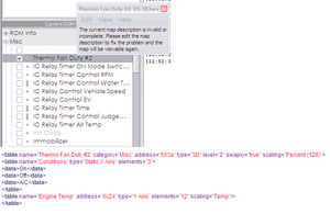

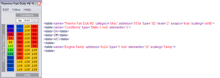

Not looking so good for 94170014:
I tried fiddling around w/ addresses... remember I'm the code idiot.
Are the values in the table supposed to be "throttle % for the cooling fan" in effect? I didn't know the fan could be throttled. (clearly mine is way off anyways since if that is true you couldn't get 128% fan duty)

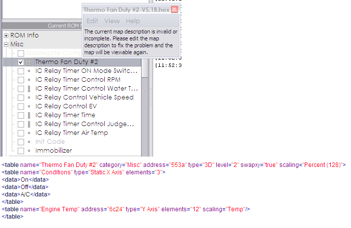

Scaling is wrong. Try - scaling="Percent (128)"
Made things worse:

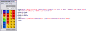

I have read the whole thread. The info is everywhere. Too disorganized for someone unfamiliar with code to figure out. Perhaps this is it though:
Okay. To be clear, what needs to be added to a 94170014 or similar variant is the following (for the fan map):
Code:
<scaling name="Percent (128)" units="%" toexpr="x/1.28" frexpr="x*1.28" format="%.0f" min="0" max="100" inc="1" storagetype="uint8" endian="big"/>
<table name="Thermo Fan Duty #2" category="Misc" address="553a" type="3D" level="2" swapxy="true" scaling="Percent (128)">
<table name="Conditions" type="Static X Axis" elements="3">
<data>On</data>
<data>Off</data>
<data>A/C</data>
</table>
<table name="Engine Temp" address="6c24" type="Y Axis" elements="12" scaling="Temp"/>
</table>
And I got this:
Seems to look correct now... all except for that stupid display problem w/ 1.35+.

Yeap, you got it! :-) See that wasnt so hard, just a little time to search.
Your temp scale address is wrong. Just change it to 67f8 and remove the / from A/C (make it AC) and you are right to go. Mine displays A/C but maybe different versions have problems with that symbol in the code.
ace33joe, the maps dont control the max temp. They control the fan, which does what it can to control the temp. To test the map you need to be logging your engine temp and have the laptop in sight where you can see the fan at the same time. Watch to see when the fan turns on and note the temp. Change the map and then see if it changes the temp when the fan turns on. Cars running a thermostat mont benefit too much from turning the fans on earlier. Usually 81C is about the coolest you will get the car. 99.9% it is the 3 column map. The 9 column may be related to road speed or to turn on the A/C fan if the engine is too hot. Just need some more time for testing.
