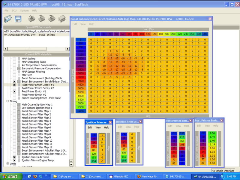

HA HA! I understand a *little* of this stuff!! huzzah!
Thanks Matt!

To verify the control map is working, try dropping the 100% values for 50 and 62 degrees down to zero. What you should notice is by 50 degrees the car should feel alot more alive as the warmup retard is dialled out, as it normally would have felt with the motor at operating temp.
You can zero the whole map, but the point here is to prove that the map is actually functioning correctly as a control map. You can see what we go through when finding new maps. Find the code and what you are pretty sure it does, then go to the car and make changes that will give proof that it is correct. It is very time consuming work.

Ah, one more thing, this makes the map switching an easy job,
but beware that also periphery bits are queried with same index so other locations are used.

The speeds have already been found. You just need to log it and slowly increase your speed to see the values.

There is a slight difference between logging and ability of setting when the column shall be used right?

Fan duty logging rocks! I logged Fan duty and Coolant temp, and found that the fan turns on at 95 degree celcius, instead of 88 at the control map.
Also it turns off below 93 degree celcius.
Is any scaling might be off by 7 degree celcius? (Either I am reading higher coolant temp than Fan control unit does, or temp scaling of Fan control is off by 7?)

I looked through the code to find the actual road speeds but it was taking too much time. Much quicker to test in the field and the results have been repeatable.
If the temps dont line up you should check you are logging the correct data. For Engine Temp I believe the default Request number was 07, but the correct one to log is 10. The formula should be x-40. Just create a new Item and use these values.

yeah Evoscan uses funny MUT's to log air/coolant temps.
New evoscan has "scaled" verison which are more accurate and what the ECU actually uses...

Thank you for the good info, Mattjin and tephra. I will try the scaled coolant temp next time. Thank you!

Yes, the scaled version is what the ecu uses. It also lines up perfectly with what I see on my Blitz RVIT.

Ok so since there are no running priming maps for 94170008, i figured it's finally time to switch to 94170015.. So i transferred everything into a fresh 0015 ROM just to find out there are no definitions for "Warmup Ignition Retard Temp Control" for that ROM...
So i have 2 questions:
1. Can someone post that definition pls?
2. If instead (or until someone posts it) I zero out the values in so called Boost Enhancement Enrich/Enlean table, would that have any effect on anything else besides warm-up operation?
Here's the table i'm talking about:
