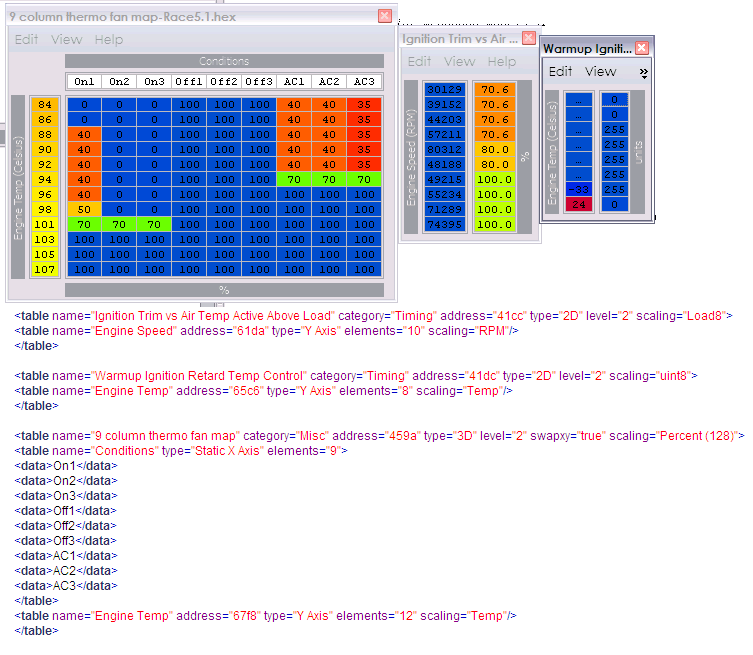

Okay, I think I got the 9-column thermo right, but what about the two ignition maps... what have I screwed up there? (94170014 Evo 8)
Edit: One more question. If I just disable FAA bit 9 I don't have to worry about the warmup ignition table, right?

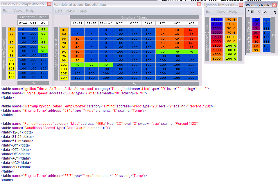

Honki, your warmup control temp scale address should be 681a, and your Air Temp vs Load map the RPM scale is at 635a.

Okay, here's what I've got for 94170014 so far. I'm guessing my "Percent (128)" scaling on the warmup map is incorrect. It was at "unit8". What in the world are those values? They don't make sense with either scaling.
BTW, the fan maps definately work. I had them all set to 100 for this past weekend's race. They stayed on all the time, both fans. lol... not sure if that helped or hurt though. I noticed I was overheating on day 2. I think maybe my antifreeze/water/water wetter mixture may have been off though... a good deal of coolant had vaporized.

Honki - The control map is based on 256 , not 128. You can create yourself another scale as Percent (256) but change the calculations to match. If you zero this map it wont use the warmup maps.
