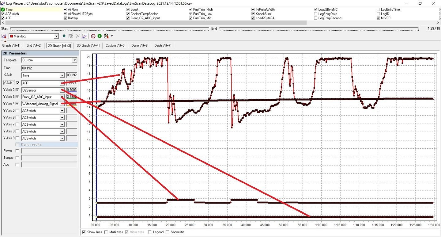

I've read through this thread 3 times and I can't determine why the patch won't turn on, which is something I have seen a few other also describing. I am running 88590715v7 with a working wideband input from the Rear O2 sensor input to the ECU. I installed the code per the directions, but when I turn on the function it changes nothing. Below is a screen shot of all the values used so if you see something out of line please let me know.
Below is what the log looks like so you can see the Wideband is working and the stock O2 Signal is still also working, but the simulated Front O2 just holds a constant number and the Wideband Analog signal just barely moves. I also know it doesn't work because I am targeting 15.5:1 and the log shows 14.7:1 per the wideband data.

Thank you for your help and it took me a few minutes to figure out how to change from "Original" to "Patched," which is done simply by going to EDIT>INCREMENT. I turned on the 4 patches, but it still does not work as designed although with your patch I got different results. The wideband (AFR) was targeting almost ~20:1 at idle and the front O2 Signal was no longer working.
I suspect the problem resides in how Tephra 88590715_v7 applies the rear O2 patch for running the wideband, which perhaps uses a different address. Can you provide your XML code for the Rear 02 patch that allows you to run the wideband. I probably need to go through the original thread for Logging AFR through the rear O2 sensor and verify mine is setup that way since that was the basis for MrFred's mod to work correctly.
