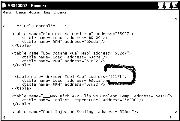

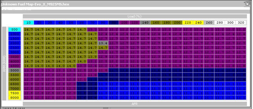

Answer me, what it for the table? I try will learn to build xml-files, here have found.
Attached Thumbnails The definitive EcuFlash Evo 10 thread-xml1.bmp   The definitive EcuFlash Evo 10 thread-fuel.jpg
