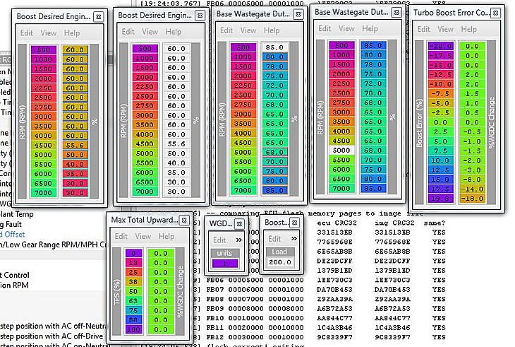

Ok. To bring this back from the dead...I'm having VERY similar issues. I am fairly new to tuning and have read over and over, searched over and over, cannot figure out my error.
Below are my settings and a excerpt from my log. I have played with baseline settings and tbec zero'd and recieved good boost results. Although, Loaderror is consistantly 19.8, but obviously only effecting boost when tbec is used.
Any ideas are greatly welcome.
-Travis

^ Above is with tbec zero'd out. Still has load error the entire time. Any advice?

With tbec zeroed it will NOT try to correct it, but it will still show the error.
