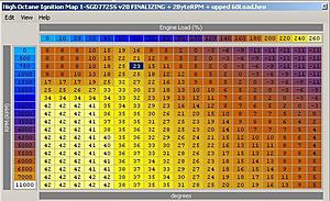

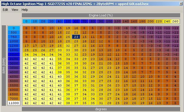

Hi all,
Need some comments here, attached is my map for reference.
With this timing map, the car feels great when I stab it hard and move off with boost.
However, if I'm stucked in traffic jam and inching forward, the car is really laggy.
On the map, I tried advancing the timing up to 70% load and then decreasing it, as it starts knocking if I advance from 70%-120%. The map is already tuned for no-knock.
My question is, could the drastic drop in timing between 60 to 70 load be the cause of the laggy move off ?
Thanks !
Note: I'm running open loop at 40% load.

My concern is,since low load don't induce knock, and I might had unknowingly advanced beyond the optimum point and start getting lag instead of any improvement. Also, I don't have Mivec

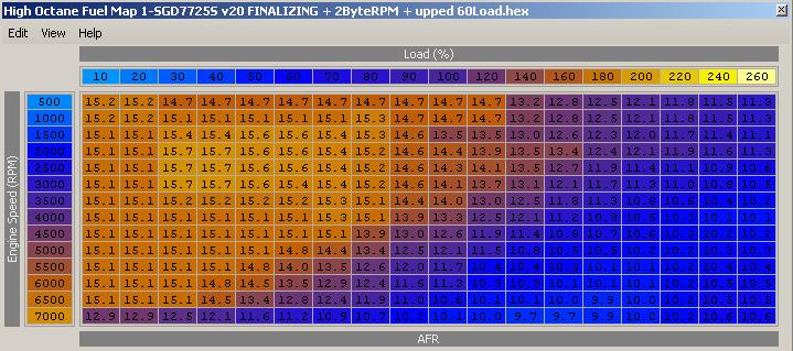

I would look to your fuel map then.
What are your AFR's when you feel this "lag" ?

Here's the fuel map. It's low load, low rpm, I think AFR is around 15.4 or so, as I'm running open loopat 40% load

What fuel are you running?
95 Octane
Might be a tad lean on the transition. Try richening it up a little bit.
Transition ? Sorry need a bit more specific instruction
Since you are on pump gas it might be a tad lean in your map from the idle cells to the "get up and moving" load cells.
That would cause the car to feel flat or fall on it's face when moving. Try richening it up and see if it helps.

Got it ! Did some adjustment, it's still "spongy"... will need to further fine tune it
