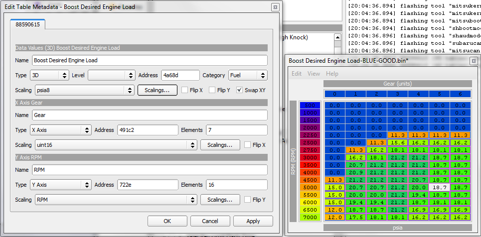

I've read through this post multiple times, and just can't seem to figure out why this isn't working properly...
I run a JDM MAP sensor along with the direct boost control. Both mods have been configured correctly, I double checked all the setting changes etc.
I changed the scaling on the "Boost Desired Engine Load" to psi8 and put in my correct values.....is this correct?
When I log, BoostError stays at -3.087 no matter how much I boost, I never see any change in WGDC, it stays 0. This is with the updated definitions for EvoScan on the front page. I can boost maybe ~11psi and thats it. In my tables I have 21psi.
My WGDC=100% under this load is set to 100 atm, I also flashed with 200 (stock value) with no changes. all other settings are kept the exact same and this is the 88590615 id.
Any help is greatly appreciated!
--Tom

Tom - which BDEL table did you modify the scaling on?
the original table OR the new 3d table?
you NEED to change the scaling on the new 3d table (and put proper numbers in too)
I have attached what I have for scalings and the 3d map. Do I have to account for the Boost Adder or does it calculate it with the 3d map aswell?
Thanks for the quick response tephra.

yeah that looks ok.
You need to still do the Boost Adder as well...

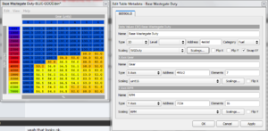

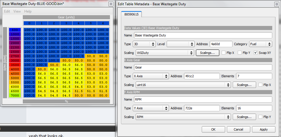

oh hold on.
what do you have your WGDC tables set to?

Attached

that should be working.

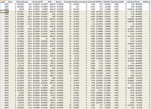

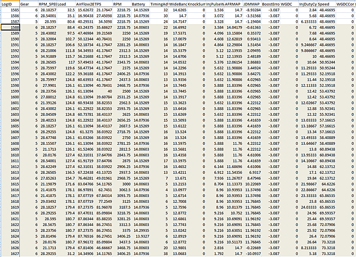

can you post a snippet of the log?
Old Apr 22, 2009 | 09:38 PM
  #534
nano's Avatar
Posts: 80
From: OC
This is the only log I got cause I just stopped logging and went straight back to the computer to find a problem, even though I'm not flooring it -- it should of still pulled WGDC, and it doesnt show anything.
Tomorrow I can post a log of a 100% TPS pull in 3rd or 4th.
Thanks again for the help with this You seem to offer better support than Dell LOL

1) i would adjust your rpm_speed/gear table so its not jumping between 5/6 gear...
2) regardless of correction you should be getting your WGDC from the map - so it should read something other than 0
hrmm this is def V6 yeah?

your not on altmaps are you?

just copy your wgdc table to your altmap version - maybe I got the labelling around the wrong way ? :P
