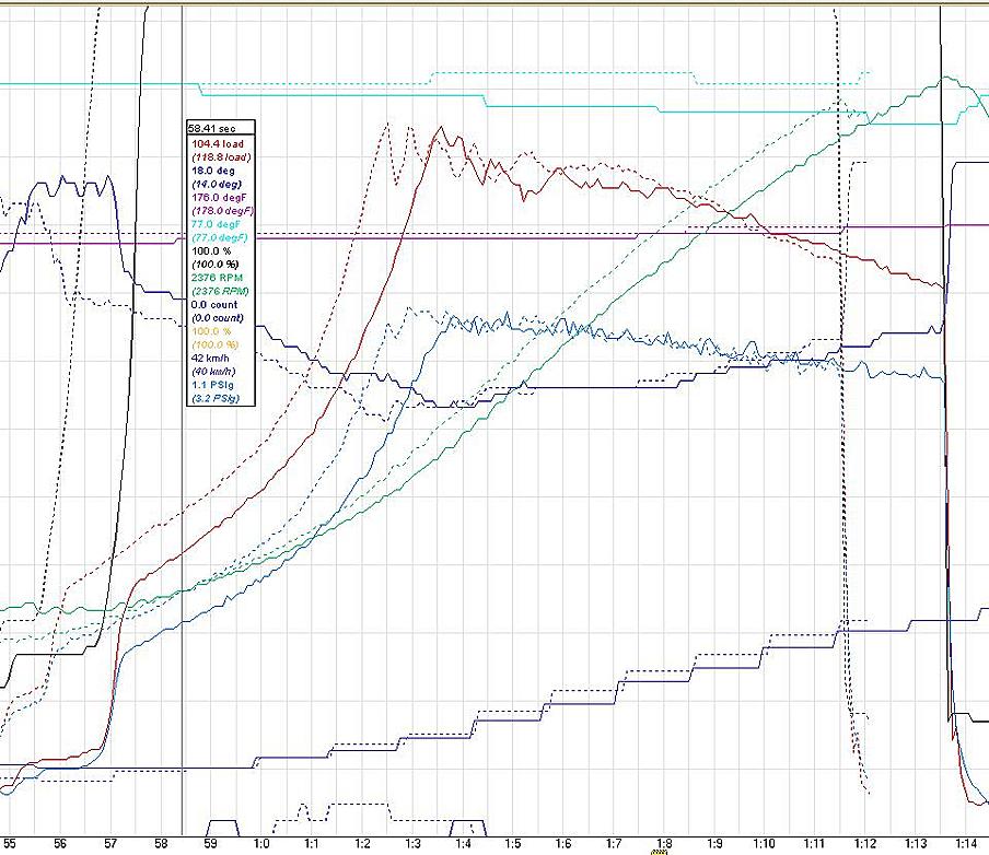

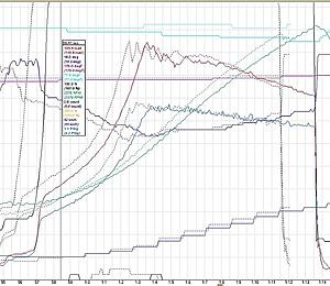

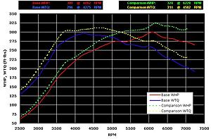

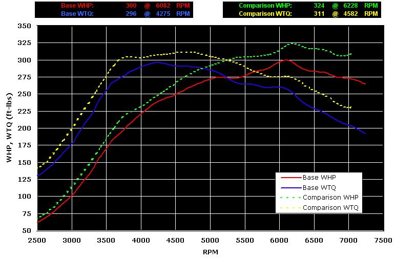

Dyno compare: cutout open-closed
Putting v5.5 to use. Thought I would show a comparison of a pull from with my exhaust cutout closed followed by it open about 30 seconds later. With it closed, I am going through a hi-flow cat (some generic hi-flow cat from an RNR group buy years ago) and the stock cat-back/muffler). With the cut-out open, it exits right from the downpipe:
EvoM comparator correction factor (re-added with correct 05 gear ratio)
Here is a comparison of the logs in LogWorks:
Dotted line is cut-out open.
Now, time for me to tune since I have my wideband rewelded so that it doesn't bang the frame/underside of the car. I want to see how much I can extract through the stock cat-back. Time to up the boost and see where I can get.

You could set it up so when you activate the cut-out switch it automatically switches to the alt-maps if you wanted to tune separately for the cut-out and with the full exhaust. Just an idea. If you'd want to do that I can help you figure out how to wire it up. should be very easy to do.

cool overlay Eric...the cutout works!
Yeah, unfortunately, I hate the noise. Time for someone to implement sound cancellation technology.
