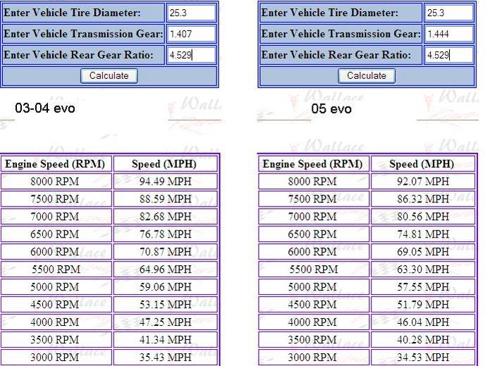

As you can see, its hard to tell in 3rd gear:
its noticeable on the dyno results though!

Right, like I said the speeds are too close to compare in a log. But the dyno results do differ a lot. In my pull, the 04 ratio is +16trq/+17hp compared to the 05 ratio.
I think you are right that the 05 has the same ratios as the IX though. I was just curious where that info is. I only have an 03 FSM and and 06 FSM. I have a spreadsheet with the evo ratios as well that was posted on the site, but it lists all VIIIs as the same.
