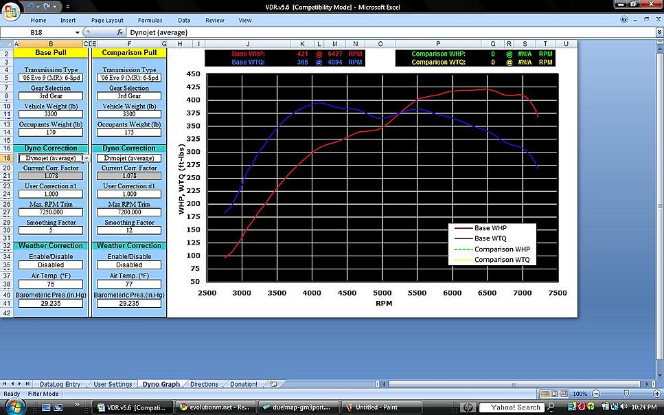

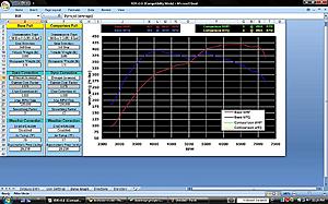

Which is the most accurate smoothing factor? If I use 15, everything looks good, if I use 5, I have a dip at 5K. Just wondering. I know a dynojet max smoothing factor is 5 and so I kinda wanted to see what that looked like.

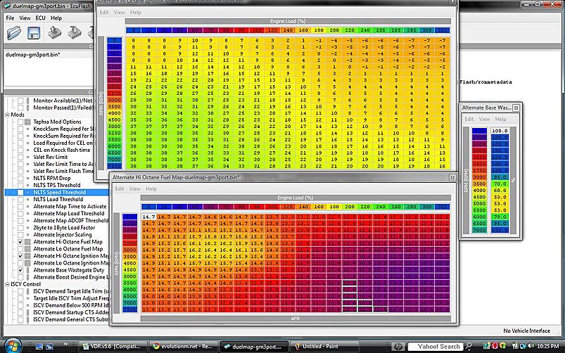

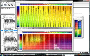

Should I regard this dip or adjust? Here's my current maps. Any recommendations welcome. The car doesn't feel like it has a dip in power/torque, but that's just the butt dyno.
Attached Thumbnails Virtual Dyno Room-Dyno Simulator-map-smoothing-5.jpg   Virtual Dyno Room-Dyno Simulator-smoothing-5.jpg

The smoothing is the hardest thing to adjust because its all in the end-users discretion. Its like that at dyno shops too since they can choose how much to apply themselves. Its hard to tell someone when to 'stop' applying the snoothing but I normally would say to stop adding it once you see the smallest bit of definition start to smooth out and become more fluid. In the graph you posted, I would add some more smoothing until the little jagged peaks in the top RPM range just smooth out. Maybe 8? I feel that the 5k RPM problem area will probably still be there a little bit. Maybe trying adding one degree in that area and see if it doesn't knock and the power level gets better.
