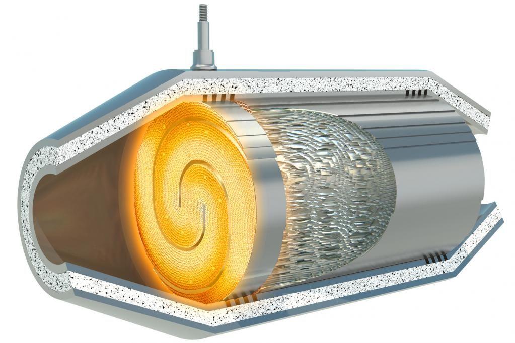

Here you get a better idea of what a heated catalyst would look like.
The idea here is that there is a heating element that heats up the exhaust gas to make the catalyst work better when it can't be properly heated up by combustion from the engine itself....
No Evo I've ever seen comes with this, so DON'T configure your car where this shows as "READY"....

I'll be honest. I skipped to the picture to understand what you meant.
I didn't even notice a "heated catalyst" section. That's probably good news because it means I haven't had it pop up. Woot.
