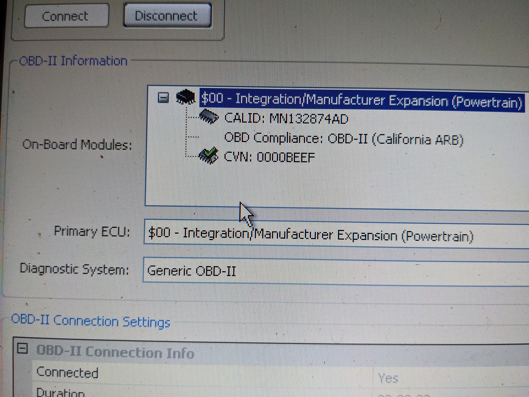

This is the 94170015 ROM code that computes the final checksum value.
/* Final FFFF8E7C Assignment */
.data:00037726 d4 4c mov.l 0x00037858,r4 ! 3ffce /* R4 = 0x0003FFCE */
.data:00037728 e5 16 mov #22,r5 /* R5 = 0x16 */
.data:0003772a da 4a mov.l 0x00037854,r10 ! 380a0 /* R10 = 0x000380A0 */
.data:0003772c 4a 0b jsr @r10 /* Jump H'000380A0 */
.data:0003772e 00 09 nop /* No Operation */
.data:00037730 da 4b mov.l 0x00037860,r10 ! ffff8e7c /* R10 = 0xFFFF8E7C (RAM) */
.data:00037732 6a a1 mov.w @r10,r10 /* R10 = Word @H'FFFF8E7C */
.data:00037734 3a 08 sub r0,r10 /* R10 -= R0 */
.data:00037736 9b 84 mov.w 0x00037842,r11 ! 15ea /* R11 = 0x15EA */
.data:00037738 3a bc add r11,r10 /* R10 += R11 */
.data:0003773a dc 49 mov.l 0x00037860,r12 ! ffff8e7c /* R12 = 0xFFFF8E7C (RAM) */
.data:0003773c 2c a1 mov.w r10,@r12 /* Word @H'FFFF8E7C = R10 *FINAL* */
.data:0003773e da 47 mov.l 0x0003785c,r10 ! ffff8e7a /* R10 = 0xFFFF8E7A (RAM) */
.data:00037740 60 a1 mov.w @r10,r0 /* R0 = Word @H'FFFF8E7A */
.data:00037742 cb 02 or #2,r0 /* R0 |= 0x02 */
.data:00037744 2a 01 mov.w r0,@r10 /* Word @H'FFFF8E7A = R0 */
.data:00037746 a0 09 bra 0x0003775c /* Branch H'0003775C */
.data:00037748 00 09 nop /* No Operation */
.data:0003774a d0 44 mov.l 0x0003785c,r0 ! ffff8e7a /* R0 = 0xFFFF8E7A Called From H'375d2 */
.data:0003774c 60 01 mov.w @r0,r0 /* R0 = Word @H'FFFF8E7A */
.data:0003774e c8 02 tst #2,r0 /* If R0 Bit 1 is clear, T = 1 */
.data:00037750 8b 04 bf 0x0003775c /* If T = 0, Branch H'0003775C */
.data:00037752 ea 00 mov #0,r10 /* R10 = 0x00 */
.data:00037754 db 43 mov.l 0x00037864,r11 ! ffff8e82 /* R11 = 0xFFFF8E82 */
.data:00037756 2b a1 mov.w r10,@r11 /* Word @H'FFFF8E82 = 0x0000 */
.data:00037758 db 41 mov.l 0x00037860,r11 ! ffff8e7c /* R11 = 0xFFFF8E7C */
.data:0003775a 2b a1 mov.w r10,@r11 /* Word @H'FFFF8E7C = 0x0000 */
.data:0003775c 6e f6 mov.l @r15+,r14 /* R14 = @SP, Shrink stack */
.data:0003775e 4f 26 lds.l @r15+,pr /* PR = @SP, Shrink stack */
.data:00037760 00 0b rts /* Return */
.data:00037762 00 09 nop /* No Operation */
This CPU instruction 9b 84 loads the word length value stored @ 0x00037842 to CPU Register 11
This CPU instruction 3a bc sums the value stored in CPU Register 11 with the Value Stored in Register 10, Then it writes the sum back into Register 10
This CPU Instruction 2c a1 writes the value stored in CPU Register 10 to RAM Address 0xFFFF8E7C(C.V.N.)
The instruction 3a bc can be changed to 6a b3. Instead of adding R11 to R10 this instruction will tell the CPU to write Register 11 to Register 10 (R10 == R11)
This has the effect of writing what ever value is stored @ Rom address 0x00037842 to RAM Address 0xFFFF8E7C
P.S. If someone wants to post the XML for this mod that's cool. I haven't done so on purpose. Please don't message me asking for XML. That's the easy part, you can figure it out, I believe in you.
