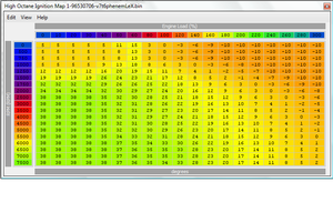

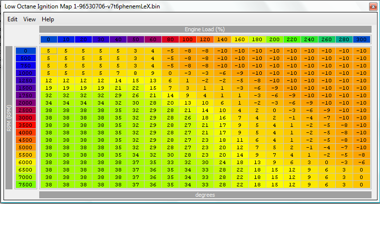

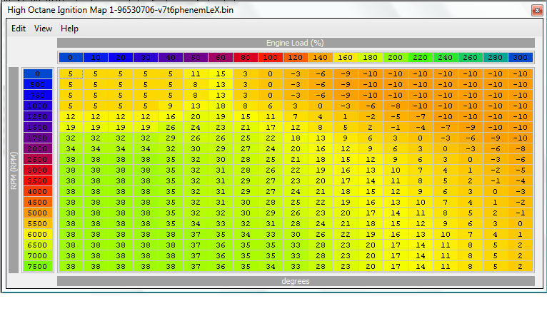

<!-- *** TIMING *** -->
<table name="High Octane Ignition Map 1" address="39d5">
<table name="Engine Load" address="6910"/>
<table name="RPM" address="68de"/>
</table>
<table name="Low Octane Ignition Map 1" address="3b5d">
</table>
Attached Thumbnails 97470001 to 96530706-v7t6 Problem ...-high-octane.png   97470001 to 96530706-v7t6 Problem ...-low-octane.png
Old Jul 26, 2009 | 10:21 AM
l2r99gst's Avatar
Posts: 3,499
From: CA
Those defs are correct. Make sure you don't have different addresses in your Tephramod 96530706 XML.
When I open your maps, they are off by a column or something, so once you hit the boost range, timing drops to -10.

Forgot to say that Y-axis i edited to 19 elements in timing maps def.... so last one 11.000 rpm is gone till i don't need one ... may be this is problem ?
What did you do? That is probably the problem.
When I look at your map it looks like it is off by a column or something. Everything is shifted and this causes your timing to be really messed up...like -10 in boost areas.
I'm guessing whatever you did is the problem.

How many RPM elements do you have in your timing map? There has to be 20. That is what the problem was for the OP here. It sounds like he deleted a column or something, which shifted all of his data and screwed up the whole map.
Old Jul 27, 2009 | 01:27 PM
LeXcite's Avatar
Joined: Apr 2008
Posts: 155
From: Kazakhstan.Astana
Exactly!
20 columns and it works ... Big Thanks ...
