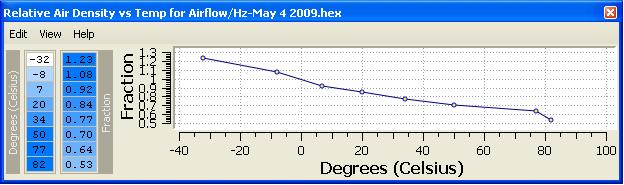

I thought someone mentioned that the stock air temp tables compensated for air temp? I assume this is the "relative air density vs temp for airflow/hz" table. It is strangely odd however, going cold would provide more dense air to the motor and it *should* lean out. That it however unless the stock air temp compensation table is a little conservative and/or it is just a bit too much compensation for the SD.

This is the table I am talking about.
Definitely strange I was thinking the stock table compensated for too much but i think it may just a product of open loop forced on. I plan on setting the bits back on and loading the rom onto the speed density thread.
