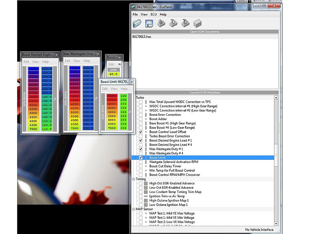

So I tried searching this thread but can't find what Im looking for. I threw the 94170015 rom on an 04 evo (100% stock everything) with an ecu from another car so I could easily disable the immobilizer so we could fire the car up. I thought everything in the rom was stock settings. I noticed we aren't making anything over 11 psi (ish) of boost. I opened the main boost tables and found the 3d tables are all 0. 60 under boost adder load, 8.6 boost adder psi, and 225 boost limit.
I have done very little with tuning boost via stock ecu and stock solenoid so I dont know what settings are needed to allow it to perform as stock. Are 0's normal or am I missing something? If Im missing something, can someone provide me with the settings that should be used for stock boost? Thank you in advance

The tables are all zero'ed out by default in a new tephra rom, most likely to keep people from forgetting to edit the tables and over-boosting. You can start by increasing WGDC to 50% for all gears and all rpm, and adjust from there.
Here are the stock boost settings for 9417. Left is desired load, then wastegate, then load adder on top, then the stock boost limit table. tables 1# and 4 are the same, hence only showing #1 tables.
Since in the V7 ROM some of the tables are 3d, just fill all the column the same.
