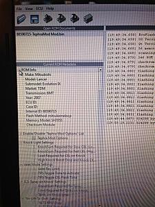

HELP with 88591715 this is my problem
Ok guys here is the stuff that I did if you can see I have the files loaded, in the seconf pic you can see that Im running my car with Tephra 88590715, and the third pic is what the 88591715 do. Can anyone help me with this Im trying to do my car SD and for some reason is not working. THX.

You're missing the sd xml to go with the rom. Looks as though the one on the first page you have to patch in the xml yourself. Download both the xmls, copy everything from the 88590715 xml and paste it into the 88591715 xml. See if that helps you.
I think is there if not can you give some guidance on how to do it. THX
Can you look at pic 1 is there

Sorry just edited my post while you were replying. If you look at the file size the 88590715 xml is 10kb while the 88591715 xml is only 1kb. The 88591715 xml only seems to have the mods for sd, not the whole xml for the rom.
Look at my previous post as well.

I just copy a paste the 07 xml to the 17 using note and still having the same issue Im going crazy with this

I have been testing it when I have the chance to, then switch back to my maf tune. So far I have done my cruise settings and about to start working on cold start before testing spool, and wot pulls (as I am working on my boost curve with my 3-port).
PM me your email and I will send you an xml that I have that works.
