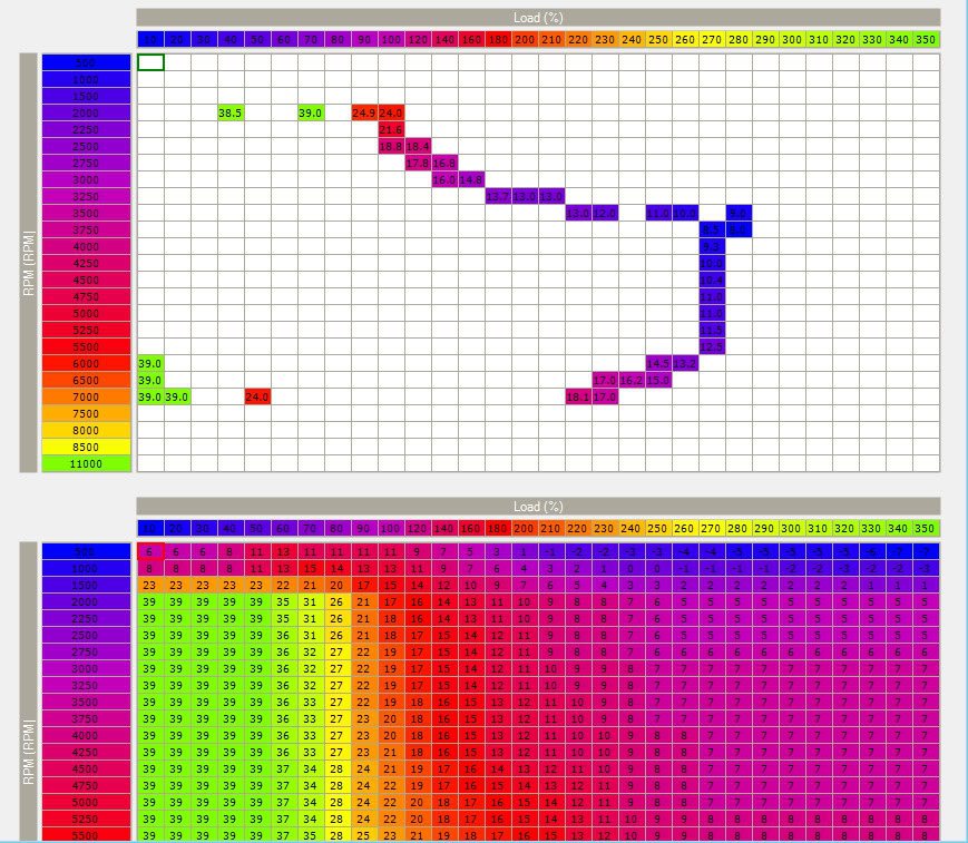

Here is a log/map trace of the same problem I am seeing.
Log was done in 3rd gear and 100% throttle started at load site 90, 2000 rpm all the way to 7000 rpm.

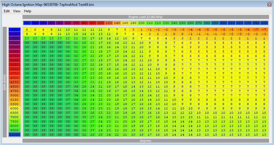

And a pic of the full iginition tables as the big maps doesn't show up fully in the map tracer.
Old Nov 19, 2009 | 10:29 AM
  #1074
GST Motorsports's Avatar
Joined: Sep 2007
Posts: 3,366
From: Hayward
Which load are you logging?
- Bryan
- Bryan
2Byte....
Edit: Arrrgghhhh, let me guess, the problem is due to me using 2Byte load, when I should be using 1Byte Load.
Old Nov 19, 2009 | 11:39 AM
  #1076
Mellon Racing's Avatar
iTrader: (38)
Posts: 9,319
From: Virginia Beach, Virginia
the difference between the two shouldn't be that significant
Old Nov 19, 2009 | 12:34 PM
  #1077
donour's Avatar
Posts: 2,502
From: Tennessee, USA
It is under boost for me. They track each other to about 100 load, but above that 1byte load can be 15-20% higher than the baro+temp compensated value.
d
Old Nov 19, 2009 | 02:05 PM
  #1078
iTrader: (38)
Posts: 9,319
even good ole "load calculated" wasn't off that much
Old Nov 19, 2009 | 02:35 PM
  #1079
nonschlont's Avatar
Joined: Mar 2007
Posts: 1,760
From: Ca
From what Ive seen, 2ByteLoad follows 1ByteLoad, "almost identically" but if your using 2byte (temp + baro), then there will be ~ 10 - 20% difference between 1byte and 2byte temp + baro.
Old Nov 19, 2009 | 03:53 PM
  #1080
donour's Avatar
Posts: 2,502
Why would you _not_ log temp+baro corrected load? It was my understanding that the corrected value is usually used for table lookups (in 96530006 at least). LOAD_RAW is quite a lot higher underboost -- several cells off.
