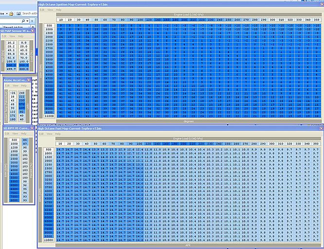

I still cannot get my car to not lean out under WOT (or higher TPS) at very low rpm. No I don't go around doing WOT at 1200rpm regularly, but this lean-out issue arises when leaving from a stop, and its worse (for some reason) when cold.
I read through all of mrfred's advanced fuel control thread and between that and the advice given already here, I'd think all I need to do is crank up Asynch_vs_TPS but it simply hasn't worked for me, no matter what I do the car just wants to lean out like crazy!
I took some logs to clearly show the issue, even with the car fully warmed up. I am still using the out-of-the-box XML that comes with 96531706 and haven't added anything from mrfred's advanced fuel control thread, but I realize that some of the values do line up. Here's my current settings as well as the log (note afr goes into the 20's!):
I've tried a bunch of different values in the 1000-2500 VE RPM tables without any real results. One thing that kinda sticks out to me is the Asynch_Accesl_vsRPM, there's 0's in the spot I'm having trouble with...
Personally I believe its just a gradiant of RPM VE which can not be accounted for in the quick and dirty Speed density conversion this type of rom uses
As such it would be best to simply curve the fuel table at that point to make up for the control. At least thats what i'm doing at them moment with pretty good results
How so? 80 load @ 1200rpm I'm at 14.7 on my map, you suggest richening it waaaay up? Care to share that section of your fuel map? That's the thing though, the map is in the 14's, but AFR goes into the 20's, that makes no sense....I know they're not 1:1 numbers but still, that's a lot of fuel missing.
Well first you have to make sure its not just tip in load going lean like i did with the async tables. Another thing was to make the RPM VE at that area sort of a compromise with the load map ve table.
The basic idea was to prevent the rpm VE percentage being so small it wouldn't handle the higher loads. Essentially if you make the rpm VE too low you squash the range of load the computer would see. Too little RPM VE would make the car lean out on top if you stepped on it at the same RPM.
Assuming 1:1 with kpa to load at 50% rpm VE its only dropping 20 load at 40kpa but its dropping 50 load at 100kpa. So the load from 40-100 is only 30 load points because of the rpm VE.
Once i had the table setup up close as i could to perfect so the values were at least touching 100% VE i adjusted the fuel table. In my case the car would only lean out to about 17 AFR when heavy low rpm throttle.

I dropped the Open Loop Load #1 table load percentages down (to around the 78% range and varying) from 500rpm up to the 2500rpm range. I've gotten a much better tip-in response from doing that in conjunction with the TPS Delta table (which hardly seems to make much of a difference for the lower rpm ranges IMO). Give it a shot and see if it helps with your tip-in issues, and keep in mind you may have to drop the appropriate load/kPa AFR ranges down to get a good tip-in and WOT for that range.
