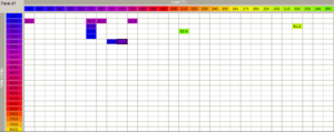

Load issues
Hello,
I cannot get tephra 94170715-OMNI-PSI-based to work. I have v5 working beautifully, but just can't seem to debug this issue I am having (Yes, I have copied all my tables / converted to BIG maps correctly). When simply reving in neutral, my 2-byte loads are very high (300+), but my 1-byte loads seem to be proper (50-80 load). My OMNI boost readings are correct too. I have attached 1-byte load on the map tracer.
I figured this was a MAF scaling issue, but I have coppied over my MAF tables from the working v5 ROM. With the old v5 ROM, the scaling was Airflow8 for the MAf scaling values, so I switched the v7 ROM to the same and copied the values over. Confirmed that the v7 MAF scaling values that are loaded by default were the same that I was using in the v5 ROM.
Any help would be much appreciated!
-Shane

Old Sep 5, 2016 | 06:46 PM
  #525
dalys8's Avatar
Joined: Aug 2016
Posts: 22
From: Bend, OR
^^^ Looks like 2-byte load was discontinued with this new ROM (sigh, I forgot that I read that weeks ago), and EVOSCAN was using AUTO for the load axis. Switched to 1-byte load and everything is making sense as of now. Looks like propper AFR's and timings are being used. I'll continue to try and figure out the issue I am getting with throttle hang / excessive knock when moving to v7. I'll try the 96530006 version to see if I have any luck there.
