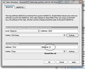

Originally Posted by Chino1
would this have anything to do with it?
To fix that you just need to right click, Then EDIT, and make the elements to 8.
You can do that in both tables, See attachment.
Attached Thumbnails **Need Help setting up V7???**  Here is your answer-edit-table.jpg
