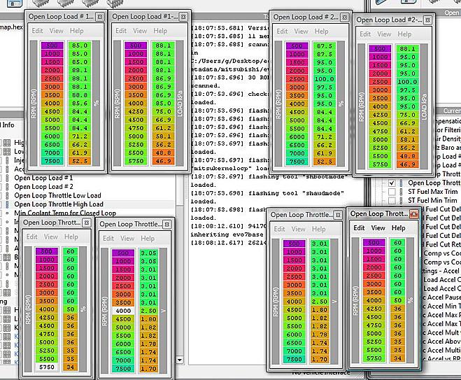

Am I supposed to move all the values in all the maps?
From reading this thread it seems like some say to just move the main maps... afr, timing, injector scaling and latencies, but than it looks like all the other maps have different values in them as well.
I'm just going to go map by map and adjust the values to how I had them in my original map.
Some maps have different scaling for different maps going from my old ROM to V7 so I should just edit the scaling to read the same as V7 and move the values over and than edit the scaling back to how it is in V7?
If I do this than the values change compared to how they were originally in V7, which means that I have to change more than just the main maps( timing, afr, injector) because the values are different in other tables as well.
One last problem I am having is that my original ROM goes up to 7500 rpm for all the "loop" tables, but the V7 goes up to 5750, because after 4000rpm in V7 the tables increment by 2500 instead of 500 rpm like they do in my original ROM.
Should I just manually change the V7 RPM values to reflect those in my original ROM.....
In my afr map I just interpolated the 250rpm values to fit in.
Heres a pic of what I mean.
Original ROM is 94170008 V7 is 96530706
thanks guys

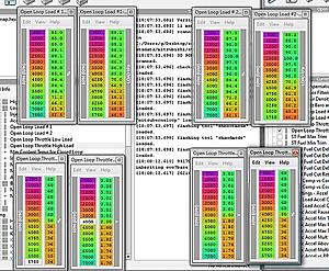

thanks guys
