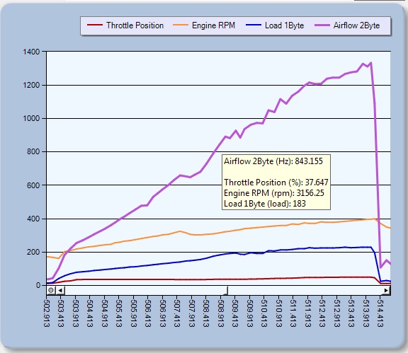

BOV flutter/stutter under acceleration-stuttering.jpg
You can see the jumps in airflow on the graph.
So I come here asking for advice. What do I check next? Is there something in my tune that could be causing this?

A BOV operates on the difference of pressure between the Intake Manifold and IC Pipes. The Throttle Plate causes this difference of pressure. This is a mechanical problem not a tuning problem.
Things that could cause fluttering:
Part Throttle Acceleration - Throttle Plate isn't opened all the way.
Turbo Surging - Engine can't keep up with Turbo.
Bad / Improperly Adjusted BOV - BOV is blowing open under boost, or it blows off with to little difference in pressure.
Your problem is most likely Improper Adjustment, crank the adjustment screw tight, or add shims. If you BOV has a second nipple, I think connecting it to the turbos boost source prevents early opening. A 1G BOV flange is close to the Greadys, you could try a Crushed or Dodge Modded 1G BOV. My Modded 1G stays closed above 25 psi.

The HKS SSQV I'm using is the v2 model, so no adjustment screw.
I even put my eBay Type-S back on, with 2 thick washers and the screw tightened all the way down, I still had problems.
I'm not sure I see the point of your modification, and how it works with the design of the BOV.

The way the SSQV operates when working properly is pressure is fed into the initial chamber, and then through the check valve the pressure also bleeds into the rear chamber to equalize both sides. When the slightest pressure variance happens (such as turbo running out of air up top) the check valve tends to stick and the valve sees a pressure difference from one side to the other and opens and then quickly closes when the pressure is normalized again. It's a wonderful design for a turbo that never drops off up top, but higher gearing places a higher load on the turbo which just can't seem to keep up, and thus the rapid opening and closing. Modding it to block off the rear chamber and allow only atmospheric pressure on the rear side essentially turns it into a standard bov with all the benefits of a positive pressure seal.
I currently run the knock-off with this mod done, and I see upwards of 28psi with a slight decline in 5th gear with no surging or premature opening, and I have tested it up to 34psi so far.

Also, did you do a vacuum line reduction? Is your BCS line on the same line as your BOV? If so, when the BCS/MBC starts to bleed air from the line, it reduces the pressure holding the valve closed (then boost drops, EBC closes again, wash, rinse, repeat).
This was initially a problem for me in 5th gear with a 35R, but is a pretty common problem in the community.
You could also be going way under/over your targets if your TBEC is set too high.
