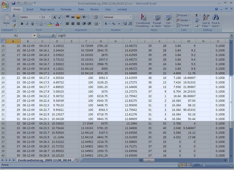

Manage to try logging today and still facing some problems.
I only managed 2 successful logs out of 7 to 8 runs. For the rest of the unsuccessful logs, I'm encountering a jump like from 3k++ rpm to 6k++ rpm and missing the in between data.
Am I missing something?
