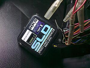

ok, i checked the ecu and pins and...looks like the previous owner had some mods done. anybody wanna buy a HKS Speed Limit Defencer?? works perfectly, LOL!!!

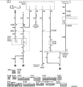

mate, i think my problem may be different to yours but here is a diagram i found which may help if it is your wiring. if you need the full electrical manual pm me. good luck!

the speed limit defencer would be sitting in between the cut speed wire thats all, just cut out the box and join the 2 wires. Theres only 4 there, 2 are going to power ground, the other 2 are joining the speed sensor wires.
Yellow - Speed sensor wire to ECU
White - Speed Sensor wire to loom
Black - Earth
Red - 12V ignition feed
no need to pay an electrician mate if you have some common sense.

yeah i know, i had a look at the connections last night after i downloaded the install instructions and it took me 5mins to unplug the cursed device (its personal, hehe) and reconnect the original wires. Quick test drive/log and SPEED is now logging!!
Now i can flash v7 over and hopefully this would have solved my boost issue with the gear based setup... from a slightly different angle, damn these HKS SLD's are pricey!
