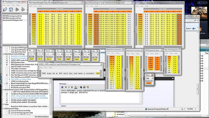

I have APPauldd's version with both the psi or load based possibilities. It is the latest Version 7 single out. 94170715.
EDIT: Sorry, I was way out in left field on that one...lol. Oh well here is my settings...
...and yes ot your settings of both those tables. Everything in my settings is up pertaing to this...

Originally Posted by tephra
yup
ok so the MUT's are correct as per MrFreds instructions
what about
as per https://www.evolutionm.net/forums/4719861-post2.html
The XML includes the address instruction:
Boost Error RAM Address = 8026 (PSI)
Boost Error RAM Address in Load Error Table = 8026 (PSI)
Old Apr 8, 2010 | 10:17 PM
  #94
tephra's Avatar
Joined: Feb 2007
Posts: 9,486
Likes: 67
From: Melbourne, Australia
yeah thats ok - 8027 is the 2nd byte of 8026.
MUT can only get 1 byte at a time, and we really only need the 2nd byte.
send me your rom where its not working, i need to see if the other bits are done correctly

I confrimed with my logs that load error is not working either....

Thanks for your help Paul. It is somewhere in the processing of how the ecu gets the source of these two int's. I have compared your V5 0015 with your V7 and am not seeing the difference anywhere. A couple of scalings maybe, but not memory locations, or hex locations... It doesn't make sense. I even thought it might have something to do with the boost or wgdc tables... but could not find anything. Other than this, I am really likeing this rom. Only my LTFT low is at +12%, so some scaling changes, but looking very good.
