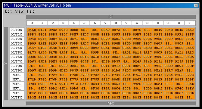

First of all, I appreciate your efforts for providing these awesome mods! Regardless of these minor issues, I love the V7 roms!
I am willing to help you resolving the minor problems, if there is something I can do.
So far I noticed gear, RPM_SPEED_RATIO_AVG, and boost error (when using psi based boost control) are not logging right, and I think related functions are not working fully yet.
Old Apr 7, 2010 | 06:44 PM
  #66
tephra's Avatar
Joined: Feb 2007
Posts: 9,486
Likes: 67
From: Melbourne, Australia
ok one at a time then
can you :
1) post a picture (readable) of your MUT_TABLE
2) post up the xml that you are using for gear and RPM_SPEED_RATIO_AVG
Did you use the V7 download or a pre-configured rom by phenem/applaud/whoever?

For the MUT table, I attached the bmp file.
For the XML, if you mean the evoscan, I used the one posted at the main Tephra Mod V7 page.
<DataListItem DataLog="Y" Color="" Display="Gear" LogReference="Gear" RequestID="40" Eval="x" Unit="units" MetricEval="" MetricUnit="" ResponseBytes="1" GaugeMin="0" GaugeMax="300" ChartMin="0" ChartMax="300" ScalingFactor="1" Notes="" Priority="5" Visible="False" />
<DataListItem DataLog="Y" Color="" Display="RPM_SPEED_RATIO_AVERAGE" LogReference="RPM_SPEED_RATIO_AVERAGE" RequestID="42" RequestID2="43" Eval="x/36.37" Unit="rpm/kph" MetricEval="" MetricUnit="" ResponseBytes="1" GaugeMin="0" GaugeMax="300" ChartMin="0" ChartMax="300" ScalingFactor="1" Notes="" Priority="1" Visible="False" />
And for the XML for rom itself, I used the Appauldd's most updated one. I added a few minor stuffs, but nothing related to gear or boost.
And for the rom, I first downloaded one from the main Tephra MOD V7 page (post #1), and then I found the gear based boost is not working, so I started fresh from downloaded from post #2 of the Tephra MOD V7 page. (Phenem's pre-configured one, Option 2 (V7 + Mods Omni 4bar))
I can also email you my updated XML + rom to you if you let me know your email address. Thanks!!!

ok so Gear is using MUT40...
if we look at your MUT_TABLE MUT40 refers to 0x8447 - which hopefully expands to 0xFFFF8447 (you might need to get the other MUT TABLE XML to double check this)
V7 uses 0xFFFF8446 for the gear ratio, so the 0xFFFF8447 is correct.
as long as that subroutine is being run...
RPM_SPEED_RATIO_AVG is MUT42 and MUT43.. which in your MUT_TABLE refer to 0x8448 and 0x8449
looking at my code, RPM_SPEED_RATIO_AVG is 0xFFFF8448... so again correct...
i just looked at my blank 94170715 V7 ROM and that code is being called correctly
can you please send me the ROM that you are using?
Cheers
CRAPPPP
found the problem...
edit - can you add this to your tephramod_94170715.xml
Code:
<table name="94170715 GEAR Fix1" category="TephraMod-V7" address="3f16e" type="1D" scaling="Hex16"/>
then change 0x6a2c to 0x8a2c
then flash and report back
