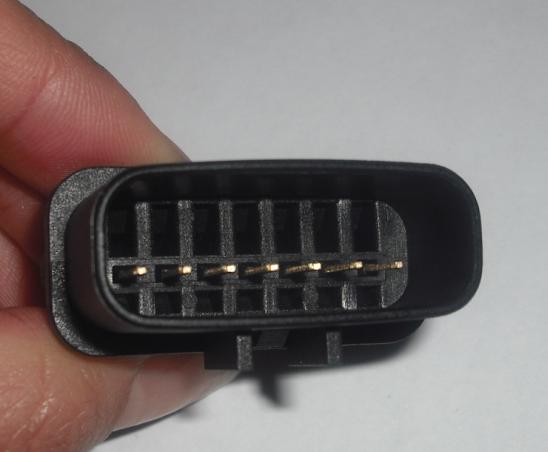

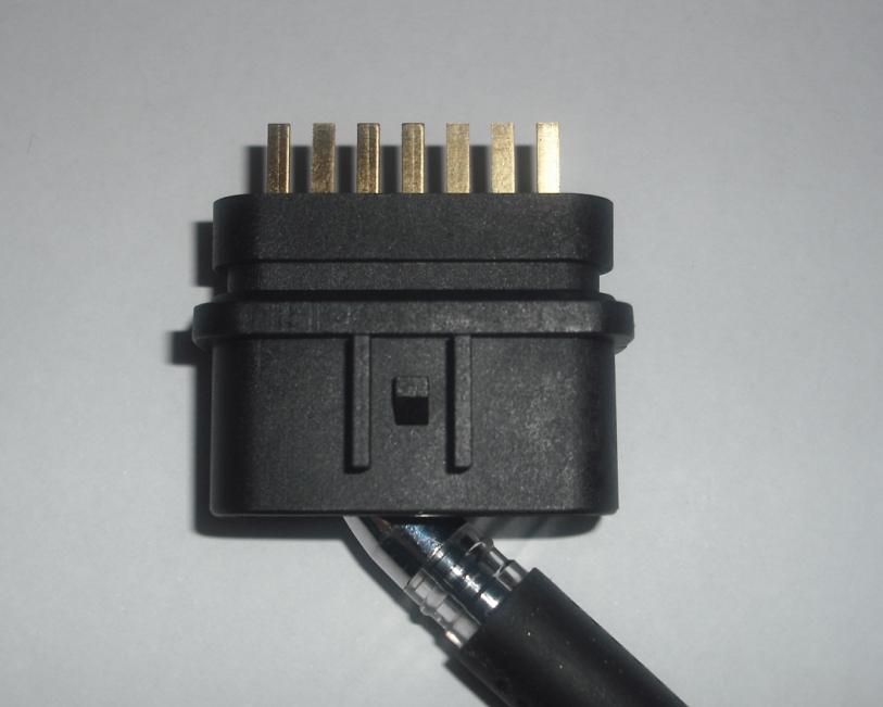

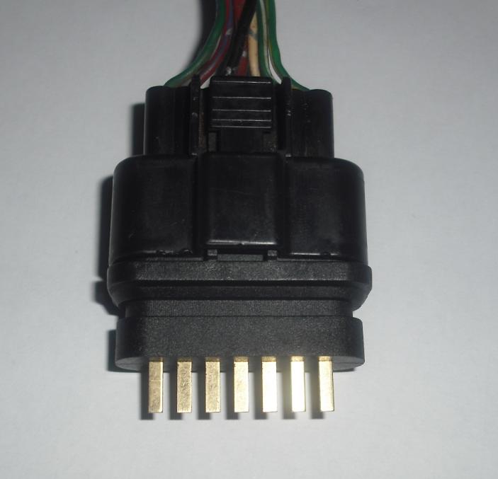

Back from the grave with good news....FINALLY.
Custom molded (rejected the first mold, this is the second mold), PA66 plastic, tin coated terminals (not pictured). Should have units ready to ship within 1.5-2 weeks.
Got tons of people on an "unofficial" wait list, but now that I actually have some good news I started a wait list. Go to http://spoolinup.com/sd.html and fill the simple form out. You will be notified the second they are available.
The harness will be $109 alone and $119 with IAT. The connector will be available separate too for the DIYers for roughly $20, custom molds aren't cheap! If anyone wants to start a group buy I'll do 15 harnesses for $89.99 e/a.
I'm also carrying ECU Pins for 8's and 9's!
Time to get ready for snowboarding!
Edit: How can I make this work with a MAP for the EDM/JDM guys?
