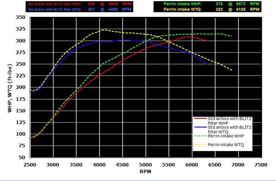

Hi guys, not sure this is the right section
I fitted a Perrin intake and pod filter kit to my JDM Evo 8 FQ300, supplied kindly from a trader on this forum
See below for results! I was very impressed with this kit, no tweaking has been done to my previous map, AFRs are still in check. The extra mid range torque is very noticeable!
Test done on same piece of road and same conditions on the same day
Std engine
Greddy intercooler kit incl upper and lower intercooler pipes
23 psi via Gizzmo MSIBC
3" Exhaust
Walbro pump
New Zealand 95 octane gas which is equivalent to 91 octane US fuel

good results there. just for my own comparision, what vehicle weight and vrier weight did you use? cheers

car weight 1410kg
driver and fuel 140kg

nice gains!

thats some good gains with just a filter, but also, thats a good gain from stock after looking at my graph lol..
im tuning tomorrow so it'll be interesting to see how close i can get to you
did you change the intake pipe as well or just the filter?

intake pipe as well

Looks like a nice gain for a pipe and filter.
