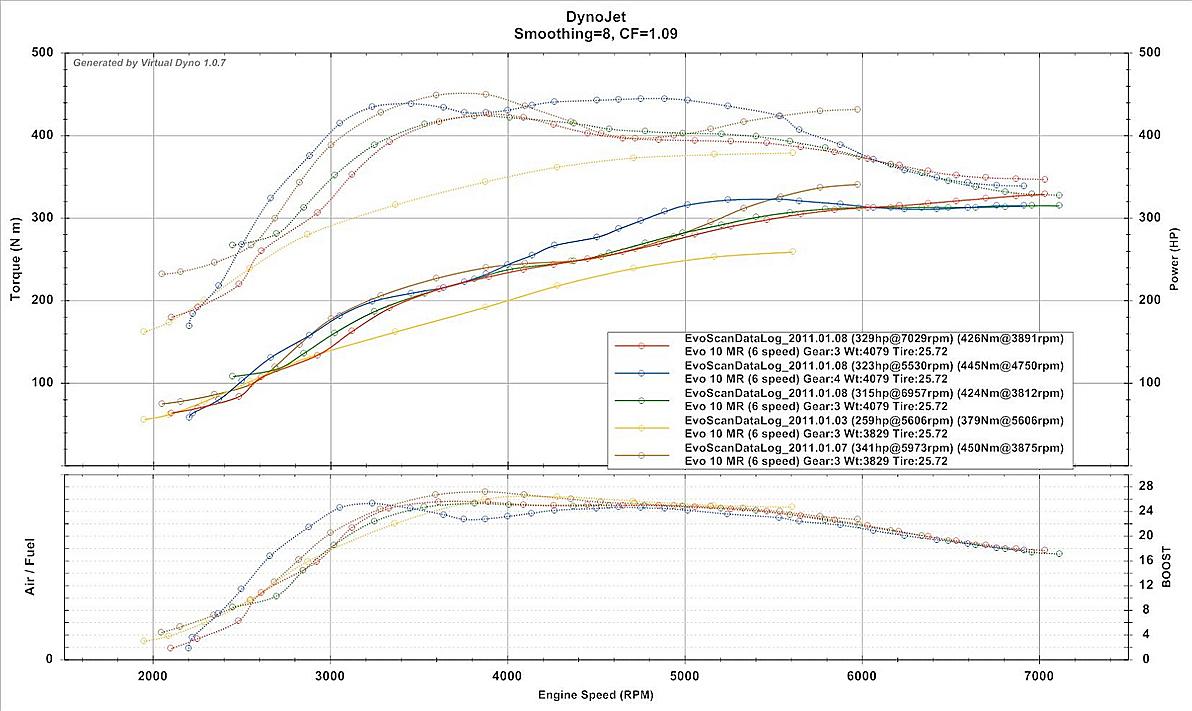

Originally Posted by germanracing
Wierd:
If I load a file that includes the spool-up (in addition to the top-power part) it tells me my car has 30hp...
If I cut that part from the file and ONLY load the top-power part it's 300hp (still not accurate but I only got my cable 2 days ago and only have 1 ****ty log)...
Am I missing something? Shouldn't it show the biggest power achieved during the run?
I spent over half an hour trying to figure it out but I'm still at square one...
Hey Brad! I figured out why it didn't work for me and a friend of me!
When you go into windows control panel, then Region and Language, then additional settings on the first page:
In germany and much of Europe we use a comma as our decimal symbol and a dot as our digit grouping symbol, the exact opposite of the US...
Is there any way you could account for that in the next version of Virtual Dyno? That way we can go back to our native comma...
Bonus graphs from my other thread, yellow is my old MIVEC map, every other pull is with my NEW MIVEC map.
Thanks for the prog, only been using it on 2 days and already relying pretty heavily on it!
I think Ive already handled this in 1.0.8 Id be glad to let you try it so you can see. But PLEASE let me know if it works.
Sure thing... Do you mean as a beta or when it releases? Either is fine for me... Cheers for the hard work!
