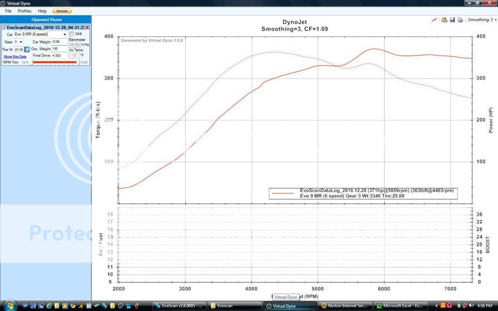

my car keeps gaining power? on smoothing 1, it had the power at 389whp and 366wtq. this graph seems like it might be right though, because I've gotten very close to these numbers on a few graphs before. I guess my car liked the cold air this morning? I've been doing runs on my way to work in the mornings on the same stretch of road, same rpm, same everything. I've been adjusting weight of the car depending on the amount of gas in the tank.
Old Dec 28, 2010 | 04:43 PM
Well you cant quote the number when the smoothing is not correct. Correct smoothing is an important when dealing with road/vitrual dynos.
And that chart there needs a lil more smoothing (ie 5-8) to eliminate that bump and so that the numbers are correct and more inline with your original/normal numbers.

Yes, I know. These are the numbers I've been getting since I started doing the pulls on the way to work every morning. These are the most consistent numbers I've gotten so far. The other graphs I had were all from different places and uncorrected for fuel load. With smoothing at 5 the bumps are eliminated and the graph still shows good power... around 365whp or so, so that's about right.

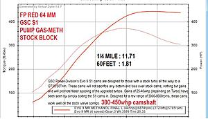

good or bad ?
Just 1 Pass at 12:00 PM
Panama Fuel its ''95 oct just the name''
the real octane its 89.7 octanes
