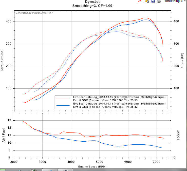

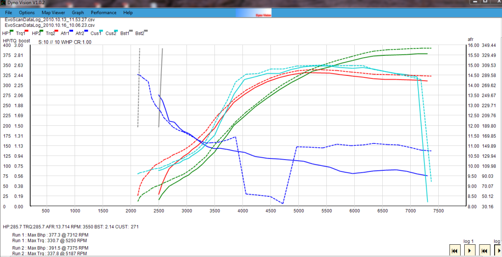

I like this program, but I have found that btwn the old version and new version my graphs are different. I happened to take a screen shot of a graph showing the difference btwn meth/no meth. When I put this into the new program my graph takes a dive at about 6600 rpm. I used the same file logs. For both the old and new versions. This only happens on the new program.
Does anyone have the older version still. This drop off is very annoying to me. At first I thought that I was suddenly down on power but I think it is simply the new "averaging" that the program does. I did not get it on the old version with the same file logs as the new. I also do not get it on Dynovision or Virtual Dyno Simulator as well.
Has anyone else noticed this? I know that the afr looks different at 3600-4600 but I think that it is due to the averaging again. These pics are of the same datalogs. I know that others must have noticed the same thing.
Normal old version
New version with the fall off

This is the Dynovision from the same runs

the newest version is pretty much dead on with a real dyno. the older versions read way to high.
And to add to that, Brad has made correction in the program to make it more accurate and constant. Please use the newest version and disregard old versions.
BTW, I help Brad with the development of VD.
Also, try doing a log till about 7600 (stock redline), then plot it. On some runs, the power calculation gets screwy at the end of the logs.
LOL I think that I am using the latest. I am using 1.07. What I do not like is the power drop. I do not it get with any other version. I am not refering to peak power as much as the sudden drop. I do not get with any other Virtual Dyno program or on a physical dyno. I am not worried about peak numbers.
I have added pics of the other Dyno simulators.
I will make a run out to 7800 when I get back into town on wensday to see how it reponds. I will also post the other Dyno simulators results. I will also post up pics of other run files showing the same drop. I like the program and have made a donation in the past but simply wish for the old version.

Dynovision

its trimming a little early thats all.
