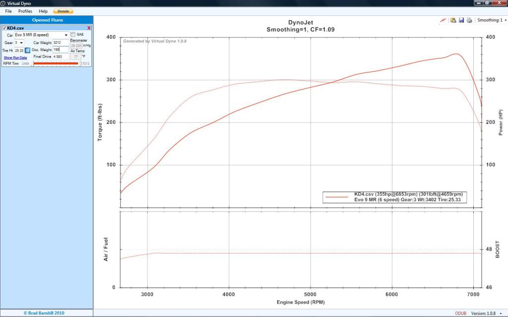

new logs. started the pull earlier, and let off a little later to try to get a full representation of the powerband.
You need to use more smoothing on that chart. Probably about 3-5
I like raw data. that's the first one that's come back that jagged. the other one I posted was a lot smoother, and the smoothing on that one was set the same.
I understand. And yes, some run will be smoother on the same setting. Regardless, for this program to be accurate, you have to use the smoothing feature properly, which means smoothing the graph till the humps are gone.
If/when you smooth it, you'll see that it will most likely be more near 355, just like your smooth chart.
BTW, I help Brad develop VD.
I know all about smoothing charts and graphs and this and that, and you sir, are 100% correct. I really just liked looking at the high numbers on this one. sue me lol this chart is so jagged though, even at 20 smoothing it's still bumpy. I normally just set the smoothing to 3 like everyone else.
