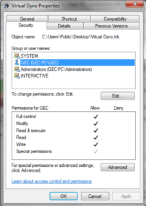

I figured the problem out for me at least. I had to go to the program and right click on it
then go to properties
then go to security and chose my specific pc name not just the one that has me and admin included and give my computer name full security rights.
Doing this I now am able to save profiles and can close the program with no errors. I could not do it before even opening as an admin. and I used to get 3 errors on close and 6 for attempting to make a profile. Win 7

I KNOW its a permission issue. I have installed it on every machine in my house and my parents machines just to test it out and it just works. Check your permissions on the installed directory. Try what mt057 says and see if that works if you are getting these errors. Those errors only happen when you can NOT write the xml files to the install directory. The only thing that will cause that to fail is a System.Security.SecurityException.
