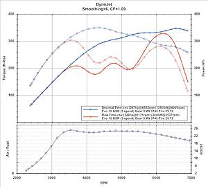

I think I found the problem and why it kept coming and going. Excel was fixing the file for me sometimes when I was cropping off 4th gear from my 3rd gear logs.
The logs are from OpenPort standalone, when there is a <time> value that doesn't include a decimal place the graph calculation pukes. I have attached an image of the same log plotted in VD twice, one time with raw format and the second plot using Excel to set the <time> column to Number format <1234.0>, one decimal place. After adding the .0 to any value that was previously a whole number the graphing starts working properly. For example, everytime you see a dip in the Raw Time graph there is a corresponding time value that is of the format 300 instead of 300.0. I mearly changed all the whole numbers to a decimal number to the tenth's place and it works fine. I will send you the logs via email that go with this plot.
So the problem seems to be with Excel and how it is resaving the CSV file. Once I resave a log back to CSV format it breaks until I go and format the column and resave. Winblows strikes again...
Good catch ill look at this.
