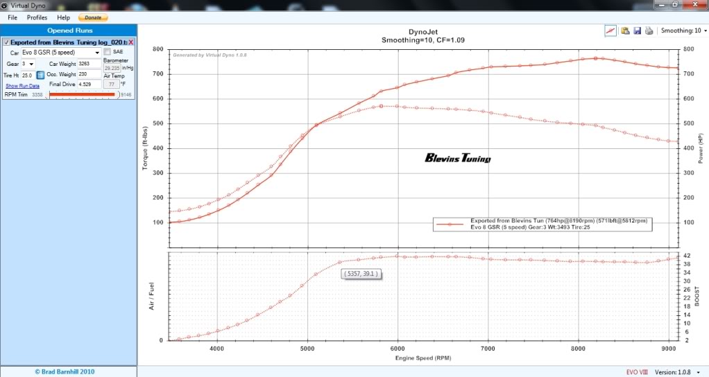

Thought i would share a VDR i did this evening on the way home from filling up at the gas station. There is a nice smooth flat spot on the HWY on the way home so i thought wth and did a nice 3rd gear pull just to see what VDR was reading tonight.
A few details on the car to give you an idea... 1st off its my daily driver, full weight with 18x9s and i run it around everyday on 42psi as is on this VDR graph. I have it tuned on pump E85 as i have for the last 17k miles on the same AMS built Oliver rod 2 liter. Head Games did the cylinder head with Ferrea valves and guides and their valve job with some core shift porting, F1I intake, AMS Race FMIC, JUN 272 cams, AMS 850R kit on the car tuned by myself of course using AEM. The car has made a max of 789WHP "Dyno Jet HP" in the past with the dump being returned back into the exhaust on 46-47psi. The dump running back into the exhaust was causing a restriction so i have since put an open dump on the car which helped quite a bit "imagine that " Id like to get it back on the rollers sometime soon and see if it wont break 800WHP now with the boost cranked Peak boost here was 41.9psi and had 39.1psi by 5357rpm rolling into it at about 3200rpm in 3rd. The VDR has always been so close to a Dyno Jet even down to the curve and RPM not just the peak #s. I have been very pleased and i must say amazed with VDR. Very accurate and useful tool when "used correctly" To everyone that has put hard work into this software i give you a big
PS. For you AEM guys i have always found it to be the most accurate using a 20hz speed on the data log for a VDR graph. If you run it as fast as it'll sample i always get inflated #s but using 20Hz its scary close! For those of you that use this with AEM you should know what im talking about.

Just so ya know its VD not VDR which is a seperate app but nice graph!!! Im jealous.
Thanks for the praise and the donation it really does help out. Keep using it and ill keep improving it.
