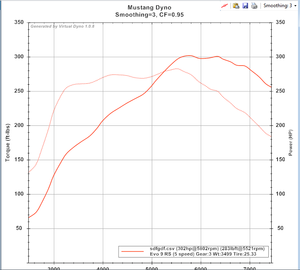

Well when I put the logs all the way up to 20 smoothing it does even out with out the drop off. This seems extreme to me, but whatever... It is smooth with out looking like it falls off a cliff. Once I find my most recent dyno sheet, I will post it and use a log as close to the date the runs were made as possible for comparison btwn the it and my old setup.
Thank you to Jay from boosted tuning for emailing back and forth with me.
Once I get my car back together I will try it out again and do all the recommended things and see if that helps any more. (Run it out longer, log less, use higher smoothing, only record WOT) I will also put my car on a dynojet the same day I make the logs, to see how they it look in comparision.

Im also looking into redoing the way Im trimming TPS values and the way the Time and RPM smoothing is done. I have an idea on how to prevent this but only time and coding will see if it works.
Cross your fingers ... got to find the time to do it though ...

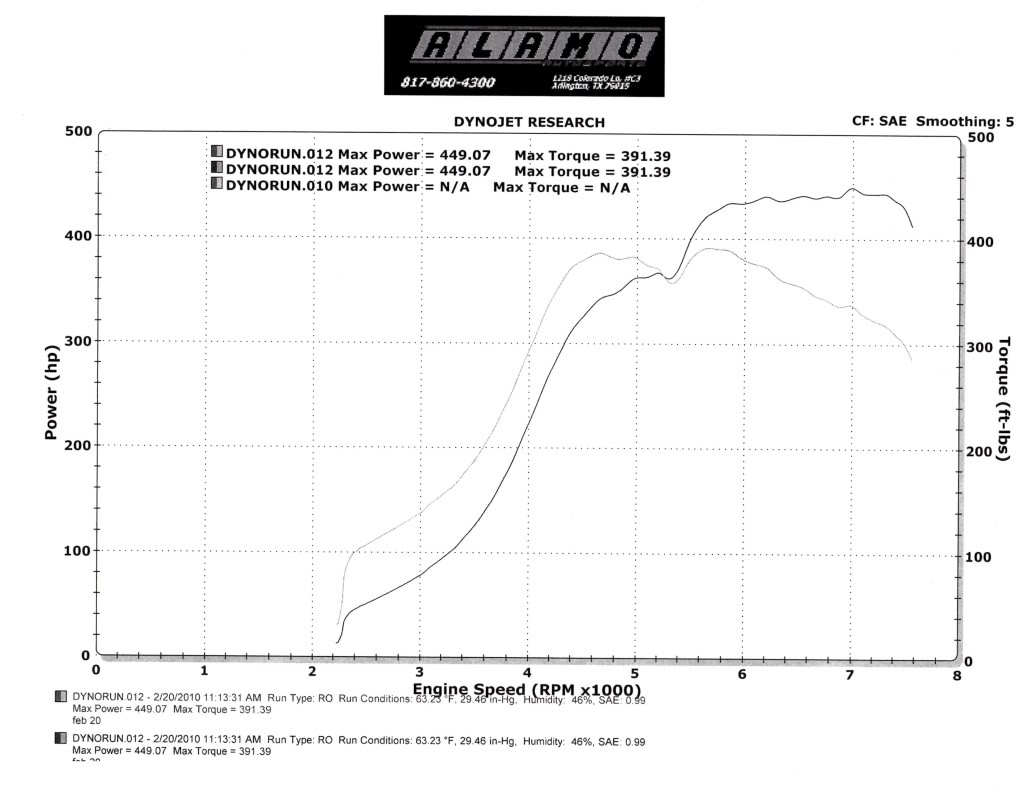

Here is my most recent dynojet dynograph with the same mods except for a Spoolin Up COP for comparsion. I installed the COP after having troubles on the dyno that day. The operator did not record my first two runs and the third had horrible miss fires. You can see the miss fires in the massive dip at where my peak torque would have been. There is no power drop at 6600-6800 rpm.

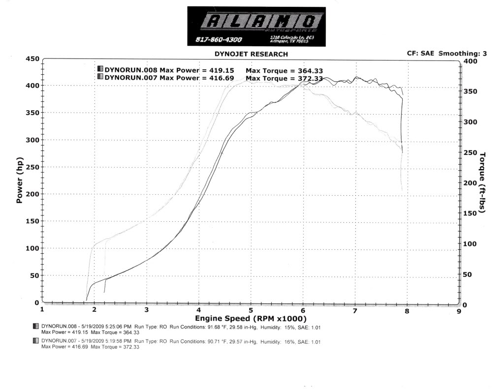

Here is another dynograph. This one is with the stock intercooler (I have a 3.5" ETS now) and my old tune so I made less power, but the power drop still does not happen at 6600-6800rpm.

Hey man I appreciate you reporting this bug and giving such detailed data. It really helps.
I have narrowed the code thats causing it down to the code that I put in to smooth RPM and TIME to get rid of erroneous spikes due to ECU delays in returning data even though the timestamp has been written. This is an issue that the loggers need to address but they dont care I dont guess. An average of the start and end time of a row needs to be used instead of just the start time for requesting data on that row.
Im trying to circumvent this error but its being a pain.
