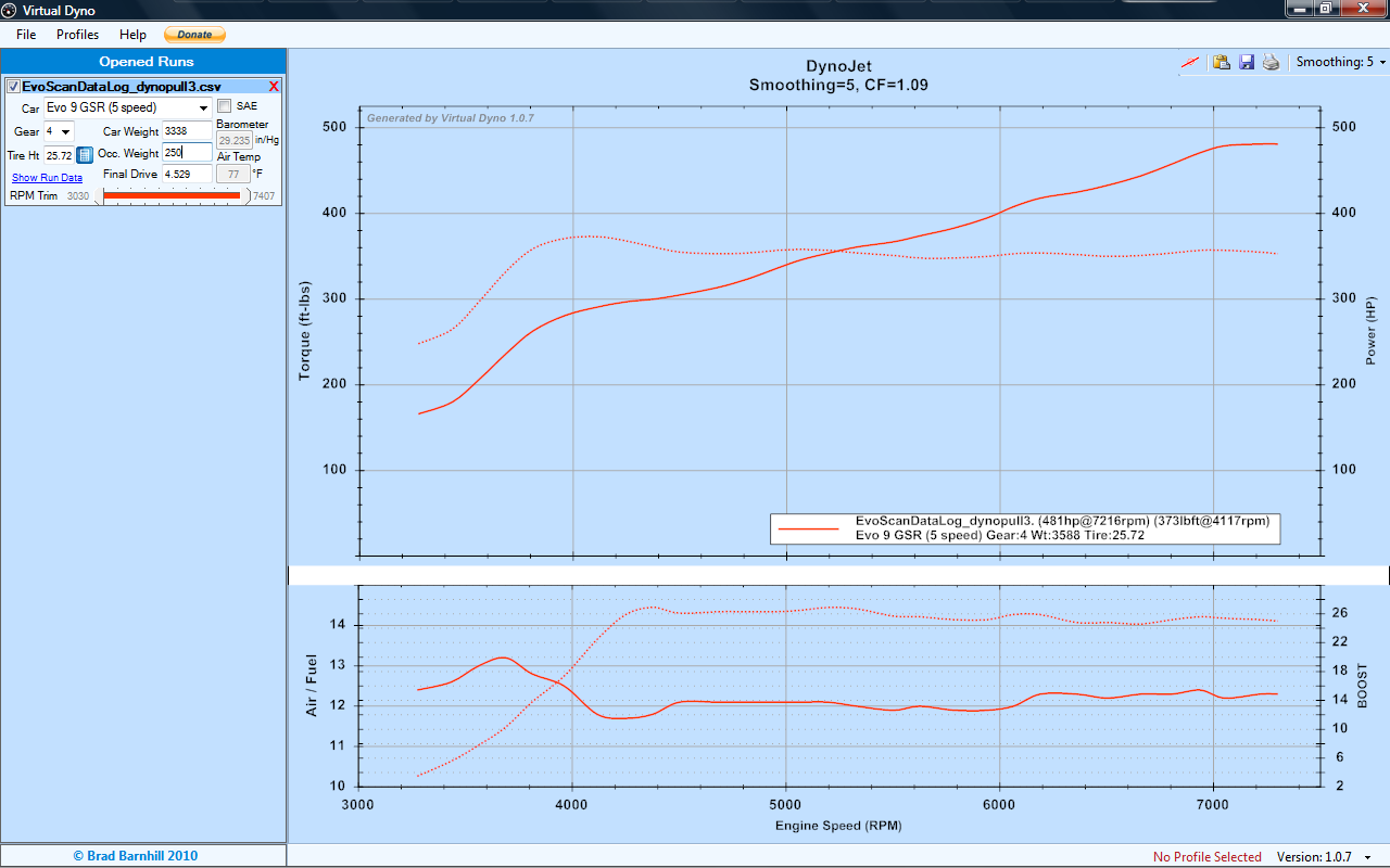

Im wondering if it was a bad log since it was down a LOT on power.
Either that or he did a pull in 4th gear and set the VD at 3rd gear.

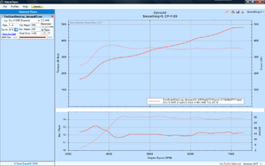

bingo! my bad, Brad... I forgot I even did this pull. 4th gear
this must have been first pull, cause from there on, I did 3rd gear...
BBK-B / E-70 / 26.5 psi

dont scare me like that Thought there was a major bug.
