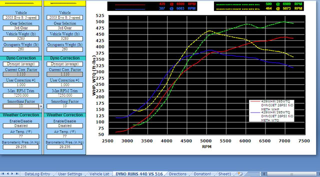

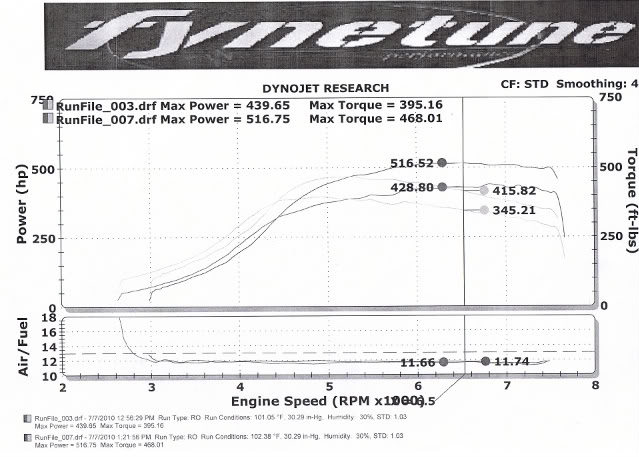

I actually was pretty on the money. Getting back from the dyno:
516whp/468wtq Dynojet smth 4
500whp/464wtq VDR (Jamie) smth 10
696whp/520wtq VD (Brad) smth 10?

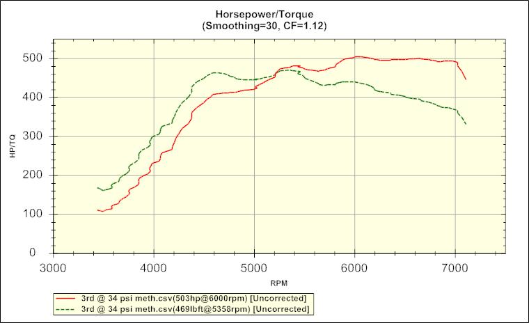

regarding being consistent. I put in my 34psi run with the new trim features, smoothing 11. I am hitting 531whp and 500wtq ?
Originally Posted by Evoryder
Brad I attached my 3rd gear log to this post.
Settings:
evo 8 GSR
3RD Gear
occ. weight 260
smoothing 11
I ran you log through and the first thing I noticed was that it needs an unusually high amount of smoothing, I put it to the max and it still couldn't cover up the spikes.
When I run it through with more smoothing the numbers look more realistic, 503 469
it also looks like this log didn't come from evoscan
see attached:

Evoryder:
I just ran your log though VDR, VD, and compared them both to the dynojet numbers. I put the dynojets correction factor of 1.03 that is shown on the dyno sheet, in Virtual Dyno and got 536/459 which is within 3% HP / 2% TQ of the dynojets numbers. I compared that to VDR set on its Dynojet setting and got 536/467 which is within 3% HP / 1% TQ of the Dynojets numbers but with a correction factor of 1.11
So its pretty close using the actual correction factor that the dynojet was using. 2-3% could all be in the difference in the way both of them smooth.
Im VERY pleased to know that Virtual Dyno is spot on with the dynojet even when using the SAME correction factor. This has me very excited and makes me even more confident that its working as it should.
By the way ... Mellon is correct that this log has a HUGE number of spikes in it, and this means that high smoothing is required to flatten those spikes out.
Below are the images to back up it up:
