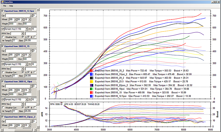

Outside of that, here is what mine looks like with 8 runs while I was on the Dyno at FSR Motorsports.
